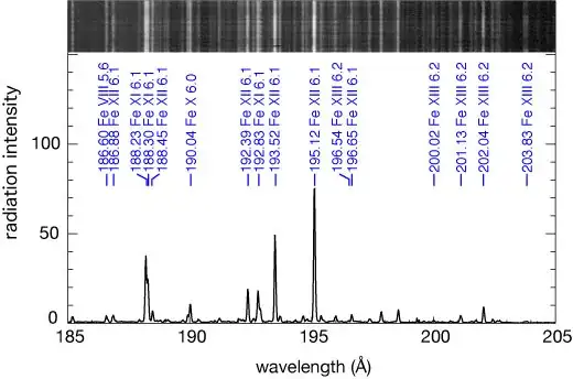

Edit: In response to the commentary on the bounty. There is no doubt at all that thermal emission - the radiation emitted by a small quantity of material in isolation, but characterised by a temperature - is not blackbody radiation. Take the example of material in the interior of a star at say $10^6$ K. We know that this material emits thermal bremsstrahlung and recombination radiation. This is not the Planck function. The intrinsic emission spectrum of such material can be observed by looking at the corona of the Sun and it consists of a continuum with a cut-off that is characteristic of the temperature accompanied by a host of emission lines.
A picture of a piece of the distinctly non-Planckian EUV spectrum attributable to thermal emission from the solar corona, measured by HINODE. (From http://prc.nao.ac.jp/extra/uos/en/no07/ ) enter image description here
This radiation must be processed in order to become similar to the Planck function and this requires the radiation field to come into equilibrium with the environment. This cannot happen in the solar corona, because it isn't dense enough to be "optically thick". Conversely, in the solar interior the mean free path of photons is a mm, or much less at the wavelength of some recombination line. If you put a piece of material in such an environment at $10^6$ K then the radiation field will be the Planck function. The populations of the various energy states and the transitions between them reach an equilibrium with the radiation and the solution to that equilibrium is the Planck function.
