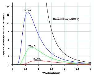

Lets try this:
It is a plot that shows the peak temperature ( one could also find the average temperature) versus wavelength.
As others have pointed out a number of processes exist in a solid body, all of them of electromagnetic nature which will contribute to the wavelength plot.

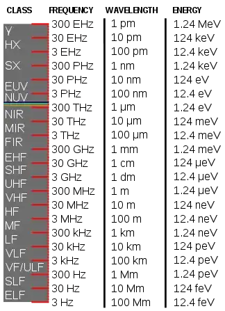

Here is a table with frequencies:
Combining the information of the two figures, one can guess at the dominant processes involved in a black body radiating.
In the red curve, which is room temperatures, one sees as dominant electron volt transitions. These are the collective continua spectra coming from the vibrating molecules in the solid each molecule in the Van Der Waals field of all the rest. Since, as others have noted, molecules have electric dipoles, magnetic moments, there will be transitions in the temporary quantum mechanical solutions for each molecule, but the effect will be a continuum because the spectrum is composed of an incoherent addition of order 10^23 molecules. Even when spectral lines are excited in the molecules and the relaxation releases a photon, this photon can interact in a continuum with Compton etc scattering which will destroy most coherence and spectral lines, due to the huge number of molecules involved. As the temperatures go higher the process continues to be incoherent, just the energies involved larger.
Because of the large number of interactions entering the black body radiation phenomenon, statistical methods have to be used as Lubos has answered.
