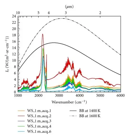

Here are some spectra taken of flames from a simulated wildfire, compared with blackbody spectra - not very Planckian (from Boulet et al. 2011). The main peak at 2300 cm$^{-1}$ is due to radiation from CO$_2$ and CO molecules. The conclusion in this paper is that the temperature is about 1500K and the CO$_2$/CO radiation is optically thick and thus reaches the Planck function, but that the flames are optically thin at all other wavelengths. Flame spectra from a wildfire

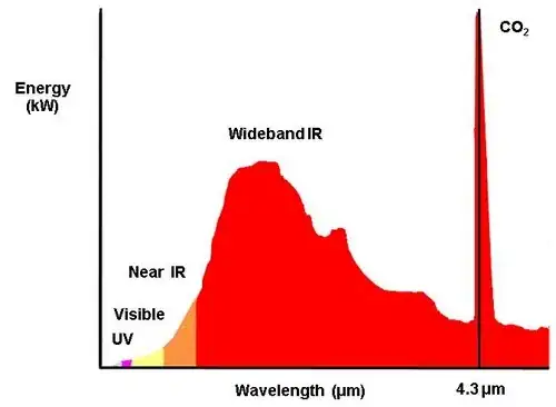

See here for a woodfire spectrumwoodfire
The text states that the size of the CO2 peak is exaggerated for visibility. This is close enough to BBR for me.
Note that you are looking at hot glowing coal and hot gases at the same time.
