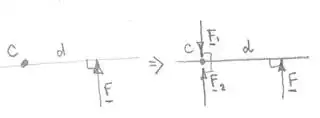

Suppose a force $\vec F$ is applied to a body whose line of action does not pass through the centre of mass $C$ of the body.
Adding two forces $\vec F_1$ and $\vec F_2$ at the centre of mass of the body such that $\vec F = \vec F_2$ and $\vec F_1 + \vec F_2 =0$ as shown in the diagram below.
There is now a force $\vec F_2 (= \vec F)$ acting along a line through the centre of mass of the body, $C$, which will only produce a translational acceleration of the body and a couple consisting of the two forces $\vec F$ and $\vec F_1$ and of magnitude $Fd$ which will only produce a rotational acceleration of the body.
Farcher
