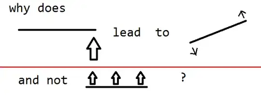

Let's say we have a metal rod of consistent density sitting flat on a frictionless surface. I intuitively understand that if I push one of its ends away from me, (at a right angle to the length of the rod) it will spin on the surface.
I'm asking if anyone can explain in simple (thought experiment like) terms why the rod rotates instead of simply moving directly away from my push and not rotating. Pictures would be great! enter image description here
I've looked at What is the proof that a force applied on a rigid body will cause it to rotate around its center of mass?, and If I push or hit an object in space will it rotate or move along a straight line? and Farcher's answer to the second question comes as close as anything to explaining the phenomenon the way I'm requesting, but I still don't entirely understand.
Like I said, I understand intuitively what will happen, but when I try to picture the individual particles of the rod I can't understand why the rod rotates instead of just moving off as a whole away from my impulse. If I cause part of the rod to move up, shouldn't all of the rod follow, just like if I grab the rod at its edge and lift it up? Obviously that's not what actually happens though. I know it must have something to do with torque, leverage, etc. but I still can't explain it.
I hope this wouldn't be considered a duplicate question since the main difference is I'm asking for a layman's explanation, not a mathematical proof. If it is the case that it can't be explained without a rigorous mathematical proof that's fine, but in that case sorry for the duplicate!

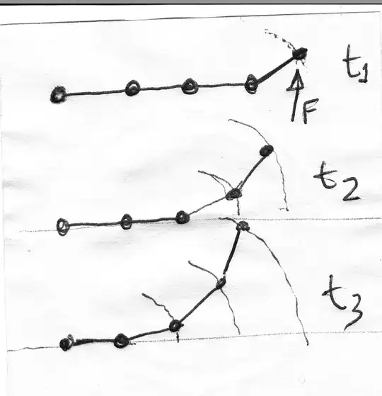

enter image description hereIt is easier to explain in terms of torque and angular momentum, but it can also be seen with some difficulty using only internal forces. Imagine that instead of a continuous rod you have instead a bunch of particles attached by cords. If you push the mass at the edge this one will tend to move up first, but due to the cord will also try to rotate around the second particle. In addition, this second particle will also be pushed up by the first particle and move up, but then the third particle will do the same to the first two, it will make them rotate around it, as they push it up. Go in sequence until yo reach the last particle and you will have a rotating bunch. It will likely not move rigidly as it is not a rigid body. Now replace the cords by superstrong and small springs and you get something very close to a rotating rigid rod.

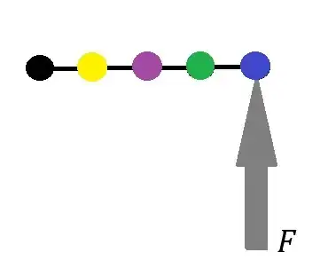

Assume that the rod is made by some particles (or molecules).
The force $F$ is acting on one particle of the rod as you see in the figure above.

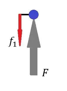

If we isolate that particle, we will have figure below (free body diagram):
Force $f_1$ is applied by the particle next to the first particle. As you see in the figure, there is a distance between $F$ and $f$ (although this distance is very small in fact). Thereby, the first particle will rotate counter clockwise.
If we isolate next particle:
There is a distance between two forces again and this particle will rotate too.
You can extend this to whole particles of the rod.
