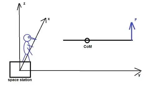

Rocket engine produce continuous force at one end of rod in free space. Initial condition: rod is at rest, not rotate, not translate in relation to space station that is near him.(Neglect tiny gravitation due to mass of station and neglect rocket fuel mass loss)
Will rod when RPM increase enough end up in pure rotation around CoM or CoM will orbit aorund center of smallest circle?

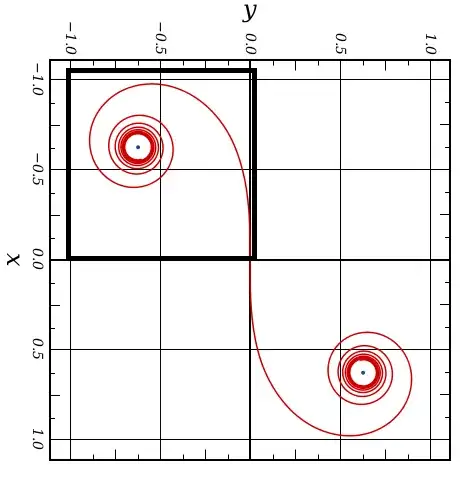

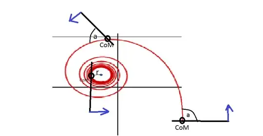

Is this left trajectory of Euler spiral, path of rod CoM?
Fersnel integral
Like this?

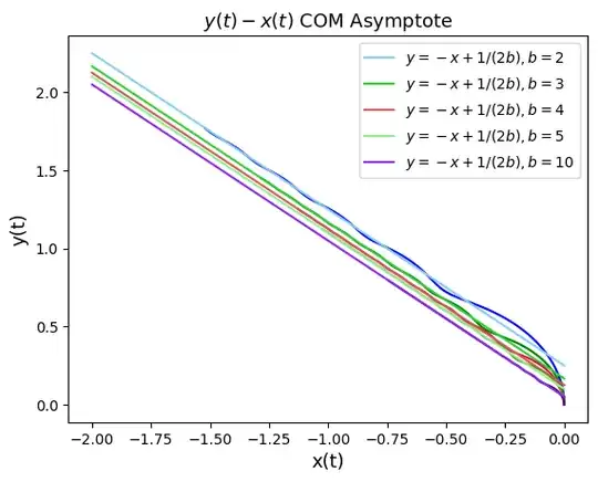

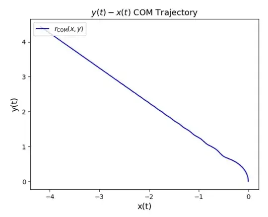

and numerically find the trajectory (we can wlog set $F=M=1$): enter image description here
Surprisingly, the trajectory of the rod COM is not a spiral as the question suggests, but an oscillation that asymptotically approaches a straight line $45^{\circ}$ anticlockwise to the direction of the initial force. This derives from asymptotic expansions of the Fresnel integrals, since $$ \frac{\mathrm{d}y}{\mathrm{d}x} = \frac{\mathrm{d}y/\mathrm{d}t}{\mathrm{d}x/\mathrm{d}t} = -\frac{ C\left(\sqrt{\beta}t\right) }{ S\left(\sqrt{\beta}t\right) }\, ,$$ so $$ \frac{\mathrm{d}y}{\mathrm{d}x} \sim - \frac{ \sqrt{\frac{\pi}{8}} \; \mathrm{sgn}\left(\sqrt{\beta}t\right) + O\left(t^{-1}\right) }{ \sqrt{\frac{\pi}{8}} \; \mathrm{sgn}\left(\sqrt{\beta}t\right) + O\left(t^{-1}\right) } \sim -1 \, . $$
In fact, as the following graph of various $\beta$ value shows, the asymptote seems to be given by $ y = -x + 1/(2\beta) $, where $1/(2\beta)$ happens to be the distance between the COM and the instantaneous centre of rotation in units where $F=M=1$, but I don't have a proof of this fact yet.
Jonathan Huang

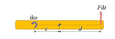

The geometry of the problem is as such
fig1
When a force is applied a distance $d$ from the center of mass, the body will have an instantaneous rotational acceleration (Eulerian acceleration) about a point at a distance $c$ from the other side of the center of mass. The distance is
$$ c = \frac{I_{\rm CM}}{m d} = \frac{ \kappa^2}{d} \tag{1} $$
where $\kappa$ is the radius of gyration of the body about the axis of rotation at the center of mass, and $I_{\rm CM}$ the mass moment of inertia at the center of mass.
The above relationship is purely geometrical and since the application point does not change, and the radius of gyration is assumed to be fixed, the resulting rotation point is also fixed relative to the center of mass and the orientation of the body.
Only when the distance $d$ approaches infinity, does the rotation center $c$ near the center of mass. On the other hand, if the force-distance nears zero, the rotation center goes to infinity and the body purely translates (in an accelerating fashion).

In deciphering the tracks of the CoM shown, place the pivot point at the center of the circles, and the CoM rotates about the pivot point at a radius $c$ as shown above.
I think what might be going on is when the tracks are near circular, the rod is actually tangent to the track and the force pointing inwards. The radius of orbit $r$ is not the same as the pivot distance $c$. The radius of orbit is such that the force is $F \approx m \omega^2 r$ (when near-circular orbits).
To derive (1) apply an impulse $F {\rm d}t$ at a distance $d$ from the center of mass. Use the equations of motion summed at the center of mass to get the response
$$ \begin{aligned} F {\rm d}t & = m {\rm d}v \\ d\; F{\rm d}t & = I {\rm d}\omega \end{aligned}$$
and note that if the body is pivoted about a point located $c$ distance from the center of mass, then the velocity at the CoM is $${\rm d}v = c \, {\rm d}\omega$$
If you divide the top expression from the bottom expression you have
$$ \frac{d \, F {\rm d}t}{F {\rm d}t} = \frac{ I {\rm d}\omega}{m c {\rm d}\omega} $$ which is solved for $$\boxed{c = \frac{I}{m \,d} = \frac{\kappa^2}{d} }$$ when $I = m \kappa^2$.
