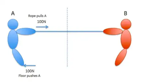

It is always best to draw a diagram to convince yourself of things in a case like this.
This is intended to represent a steady state situation: nobody is moving / winning. As you can see, there are two horizontal forces on A: the floor (pushing with 100N) and the rope (pulling with 100N). There will be two vertical forces (gravity pulling down on center of mass, and ground pulling up) to balance the torques - I did not show them because they are not relevant to the answer.
Now I drew a dotted line between A and B. Consider this a curtain. A cannot see whether the rope is attached to B (an opponent) or a wall. A can measure the tension in the rope by looking (for instance) at the speed at which a wave travels along the rope - or by including a spring gage.
Now ask yourself this question: if A feels a tension of 100N in the rope (this is the definition of the force on A), and can confirm (by looking at the gage) that the tension is 100 N, but he cannot see whether the rope is attached to a ring or to an opponent, then how can the tension be 200N? If I pull on a gage with a force of 100N, it will read 100N - it cannot read anything else (in a static situation, and where the gage is massless, ... )

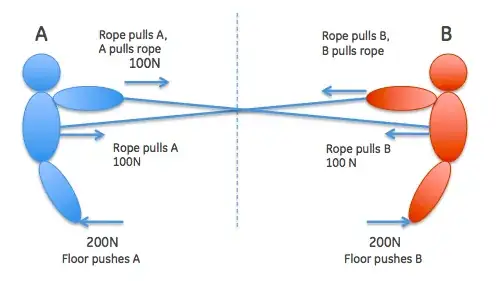

I think I understand the source of your confusion based on the earlier q/a that you referenced - so let me draw another diagram:
In this diagram, I have move the point of attachment of the rope with which A pulls B away from B's hands, to his waist. Similarly, the rope with which B pulls on A is moved to A's waist.
What happens? Now there are two distinct points where A experiences a force of 100 N: one, his hands (where he is pulling on the rope attached to B's waits); and another where the rope that B is pulling on is tied around his waist.
The results is that there are two ropes with a tension of 100N each, that together result in a force of 200N on A (two ropes) offset by a force of 200N from the floor, etc.
This is NOT the same thing as the first diagram, where the point on which B's rope is attached is the hands of A - there is only a single line connecting A and B with a tension of 100 N in that case.

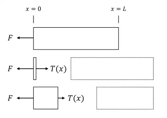

One example where defining $T = 200N$ would be inconsistent is in the case of a dynamically loaded cable. Let's say the cable has mass. The argument is based on this great answer regarding beam displacement: https://physics.stackexchange.com/a/222318/46464 Let's start with the following schematic ($F=100N$ is the externally applied force at the end of the cable):
Experimentally you would see that due to elasticity, the cable at the tip you are pulling would stretch more than on the other side. The logic here is that if you make an imaginary cut on the cable, infinitesimally close to the tip, the molecules from the right side would exert a force $T(x)$ equal to the external force, as a reaction. However as $x$ increases, it will reach a point where the molecules don't feel a force anymore, so they don't react on the molecules from the left block $T(x=L)=0$
$$T = F\left(1-\frac{x}{L}\right)$$
As you can see it would be incoherent to use tension as 200N at the tip, and indeed further complications would arise on displacement calculations because now you are dealing with a stiffness $k^*$.
