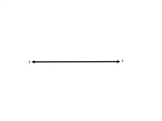

If you have two, equal but opposite forces at each end of the string, there will be no acceleration. Think about the game of tug of war. You have persons at each end of the rope pulling with equal but opposite forces $F$ so there is no acceleration of the rope. The sum of the external forces on the rope is zero. But tension is an internal force. You know its there because if you cut the rope, the contestants will go flying.
So do a free body diagram. Cut the rope at one end eliminating one group of contestants. You need to replace the removed contestants with the force $F$ that they applied in order to keep the other contestants from flying off. That force $F$ is the tension in the rope. To see this more clearly, then cut the other end of the rope and you will need to replace the other contestants with a force $F$ as well. The diagram below shows the rope as a free body with both ends cut. $F$ is the tension in the rope.
