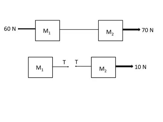

I think you are on the right track. Instead of looking at a net force on the string, which would not be possible as @Marco Ocram points out, consider that the net force is acting on a system consisting of the string and masses connected to each end. Then the system, including the string, can be considered accelerating with no net force on the string itself.
As an example, the diagram below is a system of two masses and a string, in this case without a pulley. The top diagram shows two external forces of 70 N and 60 N acting on the masses. The bottom diagram shows the equivalent system with a net force of 10 N acting on the system.
The acceleration of the system is given by
$$a=\frac {10}{M_{1}+M_{2}}$$
Since both masses have the same acceleration, the net force $F_1$ acting on $M_1$ is by Newton's second law
$$F_{1}=\frac {10M_{1}}{M_{1}+M_{2}}$$
Since the only net external force acting on $M_1$ is the tension in the string, this also equals the tension on the string, or
$$T=\frac {10M_{1}}{M_{1}+M_{2}}$$
The net force acting on $M_2$ is by Newton' second law
$$F_{2}=\frac {10M_{2}}{M_{1}+M_{2}}$$
Now we know that the string is experiencing the same acceleration $a$ at the two masses. Per Newton's second law on the string you have, where $F_{net}$ is the net force on the string,
$$F_{net}=M_{string}a$$.
If both $F_{net}$ and $M_{string}$ are zero, you can have any non-zero value of $a$ without violating Newton's second law.
