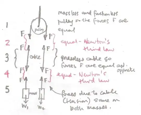

If the cable is inextensible then the acceleration of the two masses must be the same.
Work down the diagram from 1 to 5 to show that the tension in a massless cable (forces exerted by cable on the two masses) is the same.

The confusion comes from thinking that "the tension force is the weight plus the net force" for both masses.
For the lighter mass the tension force is its weight plus the net force on it $T=W_C+m_Ca$, but for the heavier mass, the tension is force is its weight minus the net force on it $T=W_E-m_Ea$.
