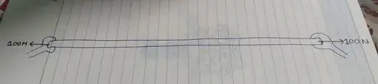

Imagine a scenario where 2 people are pulling with equal forces of 100N on a rope of some mass M enter image description here

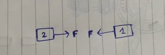

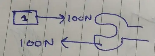

Now,the man pulls on molecule 1 with 100N, By Newton's 3rd law,the molecule 1 SHOULD pull the man with a force of 100N as well(am I right? Does the molecule 1 actually produce a reaction force of 100N which pulls the man?) enter image description here
Now,since molecule 1 is being pulled towards man,it will have some motion towards the right,as a result repulsive and attractive forces between molecule 1 and 2 would reduce,but there would be a net attractive force between molecule 1 and 2 due to Coulomb's force

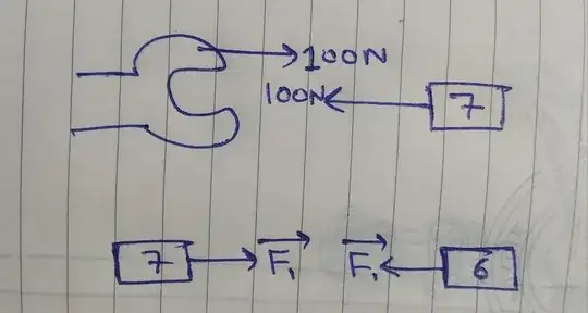

The same thing follows at the other end, man pulls with 100 N on molecule 7,molecule 7 SHOULD produce reaction pulling force of 100N, Molecule 7 moves towards man,Coulomb's force develops between molecule 7 and 6enter image description here

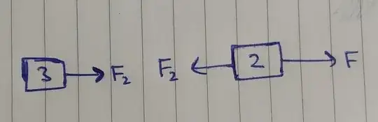

Now,2 moves to right due to force F,so again repulsive and attractive forces between molecule 2 and 3 reduce but there is net attractive electrostatic attractive forces between molecule 2 and 3(Coulomb's force I think)
Same thing in molecule 6 and 5
And it goes on and on

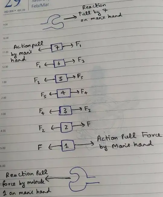

In short, free body diagrams of all the objects are as follows
Now,we know,net force on rope is 0,so by Newton's 2nd law(F=ma), We get the following values
Action pull force by man on molecule 1=100N(given in the situation)=Reaction pull force by man on molecule 1=100N(newtons 3rd law)=F=F2=F4=F5=F3=F1=action pull force by man on molecule 7(given)=reaction pull force on man by molecule 7(newton 3rd law)
Question
Which force,in this holy world,is tension out of all these forces? Many people say it's the reaction force due to pulling force,so is it the reaction force applied by molecule 1 and 7 on the men?but some people say it's the force by which one part of rope pull the other part,so is it force F,F1,F2,F3,F4,F5???some people say tension pulls the man,while others say tension is developed in the rope,WHICH ONE IS IT??????I know by 2nd law all these forces came equal in magnitude so it won't make any difference in values whichever I consider BUT I precisely wish to know which one of these is actually the holy "TENSION" Force??

Tension forces are the internal forces keeping the rope together. This means all of the $F$'s are tension forces, at different positions along the rope. In general they don't have to be all equal, e.g. in the case of an accelerating rope. But in general I would advise not getting too hung up on what a force is called. See also stress.
Puk
  • 14,100
Your mistake is thinking that there is only one tension force involved here. In fact, every point along the rope has its own tension, and in addition there is there is the tension that the rope exerts on its supports at either end. In the case of a light inextensible rope, the values of all of these tension forces are equal, so it is tempting but misleading to think of them as being one force, but in actual fact they are many forces which may or may not have the same value.
