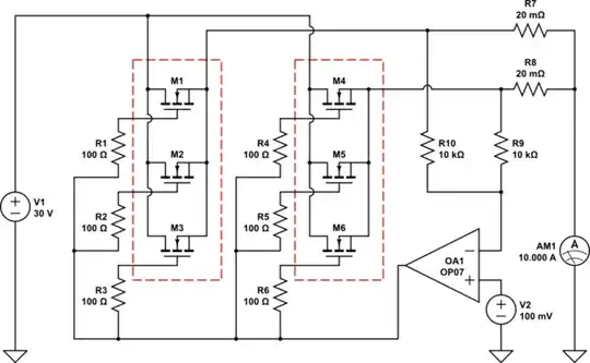

In a circuit like this:
schematic
  • If each 3 MOSFETs be next to each other and on one heatsink, is current sharing balanced?
  • If MOSFETs have TO-220 package (IRF540), how much power can I pull from 6 of them? (each 20W?)

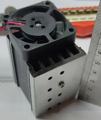

The "wind-tunnel" heatsink with a 4x4cm fan:

  • We also need to see a datasheet for the heatsink. Will you be attaching all of the MOSFETs to the same heatsink? – Elliot Alderson Aug 20 '21 at 18:13
  • @ElliotAlderson I couldn't find a proper heatsink so I "assemble" it myself, picture of the heatsink is in the question. 3 MOSFETs on each side. – ElectronSurf Aug 20 '21 at 18:17

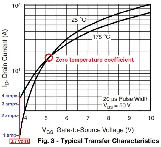

Simple answer is no and usually it ends in tears: -
MOSFETs have both a positive and negative temperature coefficient. When operated linearly (as per the question example) they can suffer from thermal runaway. Gate-source voltages below 5.2 volts can (and usually will) cause thermal runaway and, this can happen in a flash i.e. it can happen as quickly as 100 microseconds. Great, great care must be exercised. Figure 3 in the data sheet explains this (I've extended the graph and added the coloured parts for clarity): -
So, gate-source voltages below around 5.2 volts are the problem and may cause thermal runaway. Example: if the gate-source voltage is (say) 3.7 volts at 25 °C, then there may be about 1 amp drain current but, it's enough to warm the device. This means that if Vishay had plotted a characteristic at (say) 40 °C, we might see a drain current of 2 amps and the device starts warming 4 times faster due to \$I^2R_{DS(ON)}\$.
Pretty rapidly you'll be at 125 °C (taking nearly 4 amps) and fairly immediately after that you'll have a fried device. So, the first device to suffer from thermal runaway will naturally hog all the current and warm rapidly. At that instant, the other three will be unaffected until the first one goes pop. Then the next one goes pop followed by all the rest.
You have to take great care when paralleling MOSFETs in linear applications. You have to take a lot of care when using a single MOSFET in a linear application of course but parallel MOSFETs are worse or more problematic.

You'll never know because, if you are running below the ZTC (zero temperature coefficient) point, it can be "all over" in much less than a milli-second. I've read some reports that give timeframes as low as 10 μs. In that short time period, the MOSFET that dies won't feel warm at all and you'll never have got to the point where you could measure how much power can be pushed out.

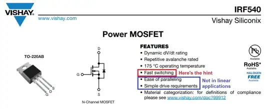

For basic reliability you need more sophistication or choose MOSFETs that are designed for linear applications. They'll still suffer from problems below the ZTC but, it won't be as pronounced as for MOSFETs that are intended for switching applications (such as the IRF540): -

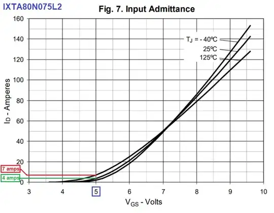

A device more suited to linear applications is the IXYS IXTA80N075L2 and note that below the ZTC point, I reckon that the worst case scenario (current change ration due to temperature) is when \$V_{GS}\$ is about 5 volts: -
Whereas the IRF540 drain current went from about 1 amp to 4 amps with \$V_{GS}\$ around 3.7 volts, the IXTA80N075L2 drain current changes from about 4 amps to 7 amps at a \$V_{GS}\$ of about 5 volts. It's hard to easily compare apples with apples (especially as I'm having to extrapolate the IRF540 graph) but, it should be clear, that as the IXTA80N075L2 warms, it doesn't raise its drain current in as pronounced a way as the IRF540.

However not all FETs are equal in this respect. Recent FETs optimized purely for switching speed exhibit strong Spirito effect and if you attempt to use them in linear mode, they will pop. Datasheet usually specifies a tiny Safe Operating Area at DC, or even no spec at DC. Here's an example from here:
If you look at the downward slope of the SOA curve you will notice it is much steeper than simply "P=Id*Vds=constant". So, at Vds=2.5V, you get 10A at DC, which is 25 watts. But at Vds=40V you get only 0.1A, which is 4W.

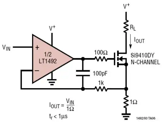

Now, since these FETs come out of the box with mismatched threshold voltage, and the hotter one will hog all the current anyway... and tempco also depends on current... it is much simpler to use one opamp and one resistor per MOSFET. Dual opamps won't break the bank over single opamps, and the matching and current sharing issue is solved. Or you can do it like the audiophiles, buy a tube of 25 and match them and then be happy about it... but if you match them at low Id that doesn't work because each FET has a slightly different tempco, so you have to measure Vgs at the current you're interested in, but then they get hot, so Vgs is all over the place, which means the result is meaningless and they end up not matched at all anyway. At this point, adding 20 cents worth of opamp per FET, plus the resistor you were going to have anyway, seems a lot more reasonable.
If you use low value resistors, do not use inductive wirewound ones.
You will probably need a small compensation cap between the output of the opamp and the input, too, because the FET is a capacitive load, and that can make the opamp unstable. From Linear appnote 105:
Make sure you test for stability at low Vds, that's where FET capacitance is the highest.

Get TO-247 package. And the answer to that depends on the Rth curve of the heat sink versus air flow, how much airflow the fan generates, what thermal interface material you use (Keratherm Red or just grease are best, high thermal resistance silpads are worst) so you'll have to do the math. Since the heatsink looks flimsy, a temperature sensor is a good investment.
