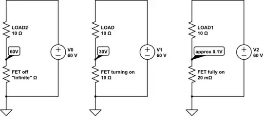

With a Vds of 10V you should be in the linear are of operation of the FET (not fully on).
In a switching application, that is a "switching" loss. When fully on, you will approach the lowest Rdson that your given Vgs can achieve, and that would be a "conduction" loss.
Image source
The voltages on the SOA graph are not the voltages across the FET + the load, just the voltage across the FET.
schematic
If the FET is "off", then the drain will "float" up with the load (so Vds will be high, but current will be very low). When its "on" Vds will be very, very low (Rds * current), and current high. So provided your FET is properly turned on, it should spend very little time on the upper-right part of the graph.

  • Not sure where you copied the diagrams from but the RHS Load FET diagrams is incorrect. It shows VDS at -0.1 V with a 10 Ohm resistive load and 60 V supply. This won't ever occur. – Jack Creasey Nov 21 '16 at 17:14
  • @JackCreasey I believe that is a tilde (~) not a negative (-) but I could be wrong. – jduncanator Nov 21 '16 at 22:58
  • @JackCreasey -- thanks for pointing that out. It was indeed a ~ to point out an approximation, I substituted it. The diagram is there to provide some illustration on Rds / Vds during the linear region, which might be confusing if you interpret the FET as a "switch". – Wesley Lee Nov 23 '16 at 11:14
