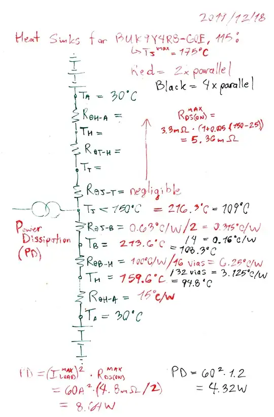

My challenge at the moment is dissipating 60A of load current through an array of MOSFETs.
Here are my specs:
Assumptions:
  • the rest of the circuit is some combination of MCU and 5V gate drivers
  • no switching of FETs after initial "on", then 60A sustained for 30 minutes without interruption
  • Likewise, 120A for 1 sec after initial "on"

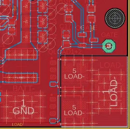

Background Info: Schematic and Board of the FETs plus gate drive portions of the circuit are attached. You will see in the board that there is a separate polygon for "LOAD-". The bottom of the board has the same outline of a "LOAD-" polygon, and they are connected together by vias around the FETs and the solder pad, which is where the negative lead of the load wire is attached.
My question:
Are the calculations that I did below for PD (power dissipation), the equivalent junction temperature for 2x parallel, and the thermal resistances for 4x parallel all correct?
The reason I ask is because I ran this 60A test with a PCB that had 2x parallel, and within 15 seconds, one of the two FETs smoked, the load wire desoldered from the pad on the PCB, and the gate of that damaged FET melted to ground, so now there is a partial short. With all that, the rest of the circuit is still operational actually. So, curious where I failed to catch the schism between theoretical and practical.

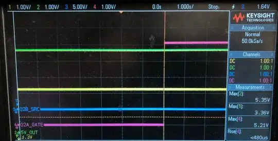

Scope of Power FET Gate Drive: Scope

    The weak link is your thermal vias. Why are not using MCPCB? also coplanarity of surface is critical to Mae thermal grease thin without voids. – Tony Stewart EE75 Dec 18 '19 at 19:19
    "dissipating 60A of load current" - current isn't 'dissipated'. What are these FETs doing in the circuit, and what is the load? Can you show a schematic and board layout? – Bruce Abbott Dec 18 '19 at 19:24
  • The 60A is sustained for the entire 30 minutes. The FETs are not being switched throughout this time. The 120A test happens separately - so when everything is "cold", or at start-up, if it helps to conceptualize. Correct, 'dissipated' is not the correct term, I should have said I need to dissipate the power generated at the FETs from 60A drawn from the load. Yes, my equation was incorrect. I edited the post with new calculation. – user2608147 Dec 18 '19 at 23:22
  • @TonyStewartSunnyskyguyEE75, MCPCB is a great suggestion. Reason behind not doing it is extra cost, as well because I have control and load portions of the circuit all on one board. – user2608147 Dec 18 '19 at 23:25
  • I will ask again.... what speed are you activating the MOSFETs? @user2608147 please answer. – Andy aka Dec 19 '19 at 13:05
  • @Andyaka do you mean the rise time at initial turn-on? That I would need to test again to capture on the scope. Otherwise, they're only being activated twice: once at minute 0, and the second time at minute 30. – user2608147 Dec 19 '19 at 15:15
  • Yes the rise time. How long does it take for the gate source signal to reach 3.5 volts for instance. – Andy aka Dec 19 '19 at 16:58
  • Also, what is the resistance of the load being switched and what is the DC power supply open circuit voltage(BATT)? I see you’ve added a schematic. That helps but what voltage is the input (load out) and what is the rail voltage That feeds RGL? – Andy aka Dec 19 '19 at 17:20
  • @user2608147 - any more details to add? – Andy aka Dec 24 '19 at 08:31
  • Rise time is ~480us for 5.2V (the rail voltage that feeds RGL). The resistance of the load is 0.80 Ohms (power resistor bank), open circuit Voltage(Batt) is 57V. Therefore, the load current is ~71A, and this was confirmed by the ammeter we had when we ran the test. – user2608147 Jan 02 '20 at 15:16

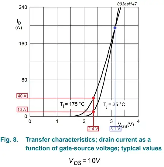

The better picture:
The facts (thermal runaway can happen) are evident in almost every MOSFET data sheet and, the BUK9Y4R8-60E,115 is no different to the others: -
What you see above is a test that involves connecting a 10 volt (high current capability) supply between drain and source and measuring the current taken by the MOSFET under different conditions of gate voltage.
Look at the blue line and dot I added - this is known as the ZTC (zero temperature coefficient) gate voltage and it happens to be 3.1 volts. If you apply typically 3.1 volts there will be current taken by the drain but that current will not change as the device quickly warms up.
Now, if you applied 5 volts to the gate, as the device quickly warms up the drain current will go down i.e. it doesn't suffer from thermal runaway. However, if you apply a gate voltage that is typified by the red line and dot on the picture above you do get thermal runaway.
So, with 2.4 volts gate-source voltage and the MOSFET at ambient temperature, it will initially warm based on a power dissipation of 10 amps x 10 volts = 100 watts. The warming will be rapid and, as you can see, the temperature will rise and more power is dissipated causing the temperature rise to accelerate. At 175 °C the power is 40 amps x 10 volts = 400 watts.
But it won't stop there - the MOSFET will continue to warm (mainly in a single hot-spot) and, at around 600 °C, the MOSFET will catastrophically fail.
Hot-spots? Why hot-spots?
Modern MOSFETs (like the HEXFET) are constructed from quite literally tens of thousands of parallel MOSFETs and each one has its own characteristic, subtly different from the rest. So, if one happens to be more susceptible to thermal runaway compared to the others at a particular gate voltage, it will warm more quickly than the others and hog most of the drain current. This is a hot-spot.
However, if the gate voltage was above the ZTC, hot-spots wouldn't happen.

You have a 100 nF capacitor between gate and source and this is charged via a VN2110 MOSFET in series with a 4.7 kohm resistor (marked RGL). You hint that the gate receives 5 volts so I have to believe you and this means the unmarked supply that feeds the 4k7 is 5 volts and, that the VN2110 gate voltage activation signal is probably 7 or 8 volts minimum.
The RC time constant is 4700 x 100E-9 = 470 us. That means that 470 us after applying the initial activation signal, the voltage at the power MOSFET gate is around 3.15 volts (63% of 5 volts).
In other words, for a period of 470 us, the gate has been in the region that will cause thermal runaway in the MOSFET and dangerously so in my opinion.
But, it’s even worse when the MOSFETs are turned off because you have a 110 kohm resistor discharging C17 (100 nF) back to 0 volts and that time constant is 20 odd times longer.

There is no benefit/mitigation in using parallel MOSFETs; they only load-share when the gate source voltage is above the ZTC point (just like the tens of thousands of parallel tiny FETs within each HEXFET).

The new version of the PCBs I designed had the following modifications:
  • Separate PCB for MOSFETs (daughter board)
  • 4 MOSFETs in parallel instead of 2
  • Larger copper area for LOAD-
  • 2 oz. copper
  • Daughter board is aluminum without vias
I will continue to test and see if I can optimize this back down to 2 MOSFETs and 1 oz. copper. Also, I have a different variation of the daughter board that is FR4 with vias, therefore lower in cost/shipping time. But, as far as this post is concerned problem solved.
