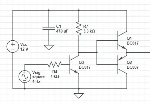

The driver schematic:
Schematic of Push-Pull Gate Driver Circuit

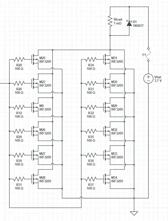

The FET array:
Schematic of a FET array

  • Is R7 sized appropriately? Not sure what the considerations are here.
  • Any sizing considerations for the push-pull BJTs? The lab seems to think that the current will be measured in microamps--but I found that quite surprising, as the point is to pull the gates high and low as quickly as possible.
  • Is there something I should do to isolate the controller from the rest of the circuit?
  • Are the gate resistors sized appropriately? I couldn't seem to find a straight answer on how to size these things, and they appear to be necessary to make the FETs all work in unison.

    At t=0, the gate capacitance will look like a short circuit. Quick and dirty calc: Twelve 100 Ohm resistors in parallel = 8.33 Ohm. 12V / 8.33 Ohm = 1.44 A. That's far above the safe operating area for BC807/817. – Unimportant Jan 31 '21 at 17:42
  • I would recommend that you simulate it in LTSpice, then you will be able to analyze what the peak voltages, currents and power in each element is depending on different operating conditions. And to verify that your circuit meets the design requirements and that you are not over-stressing any components, ie. that you stay well below the ratings of all components.. A good rule of thumb, especially for beginners, is to ensure that in all your simulations you are not above 1/3 or maybe 1/2 the rating (voltage/current/power) of all components.. –  Jan 31 '21 at 18:04
  • .. Something that is likely to bide you in the arse if you're not carefull is the fact that production tolerances leading to the different FET's having slightly different gate-capacitances can result in one or a few of the FET's taking the entire load-current associated with pulling the drain node to ground, ie. 3.6V / 1mOhm = 3.6 kA could be going through just a few FET's at the initial switch on moment (of course the internal resistance of the FET will limit it further, just to make a point..). This is not something simulations will catch unless you design it into the simulations.. –  Jan 31 '21 at 18:14
  • @Unimportant good point there, I will find new BJTs – Joel Clark Jan 31 '21 at 19:05
  • @Vinzent I don't have LTSpice, will see if I can get it working. any ideas for what to do about slightly different gate capacitances? – Joel Clark Jan 31 '21 at 19:09
  • @JoelClark You can add a small resistor in series with the source of every FET, this will have a current-limiting effect (just one way to accomplish this).., LTSpice is freeware and can be installed on almost any PC.. Regarding the simulations you should find out from the datasheet of the FET you shoose what the max/min gate capacitances and thresholds are and then you should artificially make one of the FETs in your sim a "worst-case component" to see what the peak power becomes.. Compare that with the SOA as described in Andy's answer.. –  Jan 31 '21 at 19:36
  • (@Unimportant: that's the current that would be useful. But to get even half that, the β would need to be larger than 3.3k/8.33 ≈ 400 (not too far off at 6 V even at 720 mA).) – greybeard Jan 29 '23 at 16:03
  • What makes the driver weak …? $R7/\beta _\text{Q1}\approx 100\Omega/12$, transistors near their max ratings, no bypass capacitor for C1. … what would make it stronger? I'd hope for some improvement replacing Q1 with a Darlington pair. – greybeard Jan 29 '23 at 16:20
It might take something like 5 μs to get all those parallel MOSFET gate capacitors charged (maybe 60 nF in total) and, during the first 6 to 8 volts of charging, one MOSFET will be highly vulnerable to taking a massive power surge of several kW for several micro seconds.
This is because there's always one device (in several parallel MOSFETs) that will start to turn on first and it will get hot on its die quicker than any heat sink can remove those heat joules. So consider what happens when one MOSFET starts to turn on in its saturation region and what the possibilities are of thermal runaway (yes, thermal runaway in several μs is a real possibility and is well-documented): -
I've marked a point on the graph above that corresponds with the zero temperature coefficient point for the IRF3205 MOSFET. As the gate is charging, if you are at voltages below the ZTC then the device is vulnerable to rapid thermal runaway. That's a typical graph so it might be as high as 8 volts. So, above 8 volts, as the MOSFET warms, it conducts less drain current and is self-limiting.
So, if the gate charge time is slow you might be working beyond the safe operating area of the MOSFET that is turning on first: -
Given that you haven't stated what the peak currents can be AND, it is pretty simple to improve the operating speed of your weak driver, do yourself a big favour and avoid MOSFET thermal runaway (aka the Spirito effect)

  • What makes the driver weak and what would make it stronger? – Joel Clark Jan 31 '21 at 19:06
  • Something that can deliver 1 amp comfortably into all the gates and produce a rise time of no more than 2 microseconds @JoelClark don’t skimp on this. – Andy aka Jan 31 '21 at 19:48
