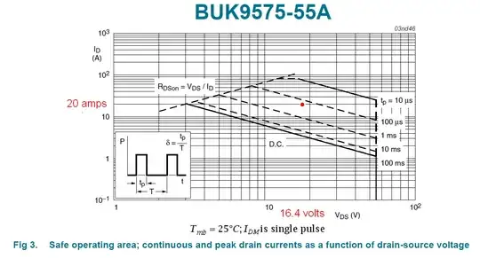

I think you will need to rethink the idea somewhat if you are using the MOSFETs to limit current because, potentially, the load might be a short circuit and all the 16.4 volts would appear across the MOSFET. Firstly the BUK9575 safe operating area: -
I have positioned a red dot to indicate where 20 amps and 16.4 volts will be on the SOA graph and clearly, the device won't be rated to survive more than a few hundred micro seconds at this power.

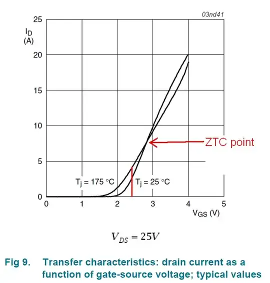

So if you decided to use multiple parallel MOSFETs, the next problem is hot-spotting. Forget about what the basic text books say about MOSFETs sharing current - this does not happen in linear applications unless you are above a certain gate-source voltage called the ZTC voltage (zero temperature coefficient).
Now you may get lucky with this or you may not but, to withstand 20 amps and 16.4 volts for a decent period of time it looks to me like you will need 7 parallel MOSFETs each taking about 3 amps.
Then, with each MOSFET taking about 3 amps, the gate source voltage will be about 2.4 volts and you are in the "dangerous" area of MOSFET operattion - you are below the ZTC point and hot-spotting will occur. One MOSFET will start to draw more current than the others and its drain current will rise as per this graph: -
At 25 degC, with 2.4 volts gate-source, the current is 3 amps and warming the MOSFET. Current carries on increasing to 4 amps because of the "wrong" temperature coefficient when the gate voltage is below the ZTC point and, without much more time having passed, your junction temperature will be 175 degC and then it's the slippery slope to failure.
The device will start to hog all the current and burn. This is a well-known problem in eFuses, linear applications and current limiters. Try googling "MOSFET thermal instability" or "Spirito effect" named after Paulo Spirito.

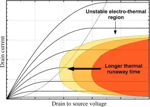

A single MOSFET potentially suffers from thermal instability in the area shown below: -

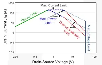

And MOSFET manufacturers usually modify the SOA curves like this: -

  • Vds is only 16.4-13.8=2.6 V, not 16.4 V – FarO Jan 09 '18 at 11:32
    @FarO this means you should be OK with 3 devices but it would be better to pick one device that could deal with the whole power to avoid any risk of hot-spotting. – Andy aka Jan 09 '18 at 11:39
