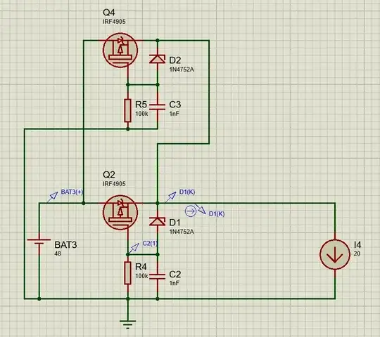

i wanted to know if my design is right ? if it has any problems ?
max Current calculation : does max current will equal root ratio max power dissipation to max R on ,
without taking in consideration rise of temperature where it is positive coefficient , so if current increase temp increase leading to increasing Ron so current decreases leading to stability this also helps with parallel fet .
max current 2 fet combined will be just summation ?

my design : enter image description here

  • If you are trying to design a reverse voltage protection device that also controls in rush current then your schematic is flawed. Also the IR document about paralleling MOSFETs is missing a key ingredient when paralleling MOSFETs used for linear control (in rush protection). – Andy aka Feb 15 '20 at 17:54
  • See this q and a for details: https://electronics.stackexchange.com/questions/472375/heat-dissipation-calculation-for-mosfet and also this: https://electronics.stackexchange.com/questions/361407/dc-operation-for-irfz44-mosfet-soa-curve-max-current-at-40v – Andy aka Feb 15 '20 at 18:04
  • @Andy aka thanks for your reply i really was amazed by thermal runaway of mosfet . But i didn't understand about the in rush protection ,aslo it would be grateful if u helped me calculating capacitance of capacitor . – Ahmed elmenshawie Feb 15 '20 at 18:54
  • The capacitor needs to be across the zener diode. Why don’t you simulate the effect? – Andy aka Feb 15 '20 at 19:48

  • If capacitor parallel to gate source is better than gate drain . So my question is it better to make one mosfet for reverse protection and another for in rush current? Or just use one for both protection? What do u think of adding capacitor parallel to source and ground – Ahmed elmenshawie Feb 15 '20 at 19:56

  • I was wondering if adding capacitor parallel to zener better or have two mosfet like in link – Ahmed elmenshawie Feb 15 '20 at 20:00

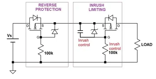

Firstly and importantly, the capacitor on each MOSFET needs to be in parallel with the zener in order to achieve inrush current limiting but, the confusion here surrounds both MOSFETs being in parallel. They are actually positioned to be reverse polarity protection devices and cannot be used as inrush limiters (contrary to what I originally understood and wrote so, sorry about this).
So, instead, think about the reverse polarity circuit (without a gate capacitor) then, after that MOSFET circuit, think about using another P channel MOSFET with its source after the reverse polarity MOSFET's source: -
So, assuming you do this, the rest of my answer is relevant....
You need to think about the CR time of the capacitor and resistor to ground. Quite literally C x R is the time constant and for this type of circuit, the MOSFET might be regarded as being fully conducting at about 50 % of CR. This assumes that the MOSFET fully conducts at about 12 volts between gate and source.
Given that your supply is 48 volts, at the end of the first CR time period you’ll get about 24 volts across the capacitor, it isn’t too far wrong to estimate that at 50% of CR, the voltage will be 12 volts.
However, a lot of MOSFETs might be pretty well conducting at 3 volts so, there’s a fair degree of slop in this gearbox. That’s why I recommend simulating and messing around with values etc..
As for paralleling MOSFETs, it’s not clear cut by any means when operating them linearly through the dangerous zone so play safe and choose MOSFETs that are intended for linear operation. The main clue is page 1 of the data sheet. If it says typical applications are switching circuits or converters then make absolutely sure you give enough headroom. Alternatively go to a company called IXYS and pick the appropriate range designed for linear applications.
