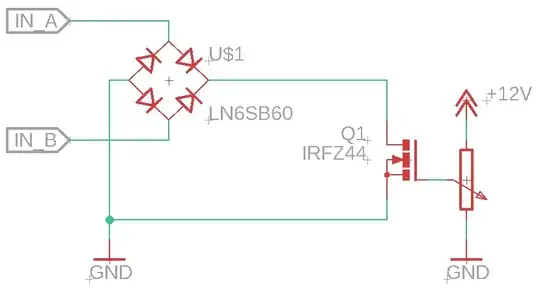

I am trying to make a system that acts as a constant current/power load. At the time I am working with the power electronics, but I am having some trouble with the MOSFET in the circuit.
Below is a symplified schematic:
A power supply is connected to IN_A and IN_B, the input voltage needs to be rectified so the MOSFET's drain voltage is always higher than its source voltage.
The input voltage is rectified with a full bridge rectifier whose + output is connected to the drain and its - output is connected to the source of the MOSFET. The - pin of the rectifier is also connected to ground.
This common ground connection is present in order for the MOSFET Vgs to get referenced to the common ground. This is done in order to fully turn on/ off the MOSFET with the 12V swing the potentiometer is capable of provide to the gate of the MOSFET.
The principle of operation of this circuit is that the current flowing through the MOSFET is proportional to the voltage on its gate. We can make an analogy that the MOSFET is acting as a variable resistor, which is actually true, because in order for the MOSFET to limit the current draw it changes the Rds parameter. With this in mind we can dissipate a lot of power in the MOSFET.
The problem I am facing now is that my MOSFETs keep blowing out when loaded. I have tryed several different MOSFETs with the same results. When loading the circuits I am using a 24V power supply with a 3A current limit. I have noticed that the circuit works fine with currents up to 2A with a MTP7N20 (Is-7A Vds-200V), but when I tried using an IRF540 or an IRFZ44 those blow up almost instantly.
I suspect that it has to do with a thermal dissipation issue mainly because niether Vgs_max or Vds_max was exceeded on any of the cases.
It is important to say that the MOSFET has a huge heatsink that is electrically isolated and also that is has a layer of thermal grease to help with heat transfer.
Power dissipation on the MOSFET will always be lower than the whole system dissipation because there is a voltage drop across two of the diodes of aproximately 1.4V, (0.7V per diode.)

With 24V @3A power supply a maximum of 72W should be dissipated in the system. Hence I thought that the MOSFET won't get damaged.
Maybe I only need a bigger heatsink.
What kind of protection circuitry can I use in order to protect the MOSFET from blowing up?
I know that maybe I am over simplifing the driver circuit, but this should in theory work, right?
Please let me know what you think.

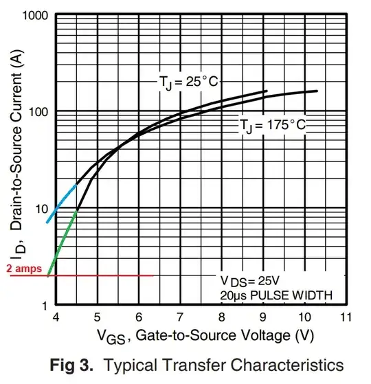

Think about what happens when controlling the MOSFET drain current at around 2 amps: -
I've extended this graph in the IRFZ44 data sheet to demonstrate what I mean.
So, you apply about 3.9 volts between gate and source and, at an ambient of 25°C you initially get 2 amps flowing. Now the next bit I'm describing is in ultra-slow-motion because, in reality, it can happen in less than a millisecond.
Because modern power MOSFETs are built with several thousand tiny parallel MOSFETs (think HEXFET) just one of those tiny parallel internal MOSFETs will get hotter than the others and, will start warming immediately. It then takes more current (as it heads from the green curve to the blue curve above). It's starting to hog all the current and all the current is focussed on one tiny part of the die.
And, because the current only occupies a tiny area on the die, it warms very, very rapidly; its localized temperature shoots past 175°C and, as it does, it takes even more current until less than a millisecond later it's reached something like 600°C and you have a dead MOSFET.
No amount of heatsinking will prevent this either. It's over and done with before other parts of the MOSFET have begun to warm. Hence a heatsink doesn't help.
If you were trying to control a drain current of over 40 amps (with this device), you'd be operating in the area where it is thermally self-limiting and protecting. No such luck below 40 amps for this device. Choose your MOSFET carefully in linear applications where the MOSFET is expected to run in saturation.

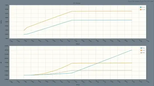

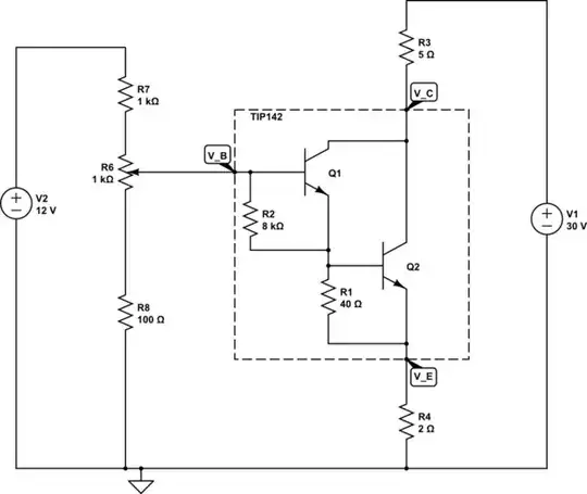

I believe that you will have better success with a bipolar transistor. This is similar to a current sink in another one of my answers. Drive a coil with an Arduino
schematic
This plot varies V1 with the pot set at the midpoint. For the range where V_E is flat, the current is fairly constant (it will vary some with temperature due to the B-E junctions).

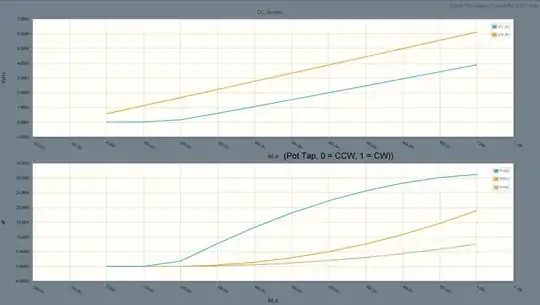

This plot varies the pot tap.
You can tinker with the values somewhat. But you want R4 to be an ohm or a few ohms for stability. Don't make R7 too small or you could blow out the transistor base when the pot is fully CW.

  • I think i'll give it a try with BJT's. I wanted to use MOSFETs for being able to isolate current flows from both devices. If I use a BJT I'll have to galvanic isolate the signals that goes to the MCU in case anything goes wrong, – Cheche Romo Sep 29 '22 at 17:56
