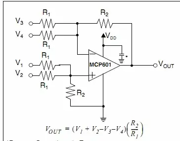

I have a front end module that generates an (ECG) signal that varies from +/-2.5 V. I want to shift this signal to 0 - 5V. What is the best way to do this? Would a summing amplifier like the below circuit good enough? With R1 = R2 and V1 = 2.5V, V2 = my signal, V3 = V4 = GND

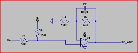

Here is one way to do it:
Level Shift
The resistive divider supplies 1.25V to the non-inverting input. This can be replaced by a dedicated voltage reference if desired. You will need a rail to rail output opamp.

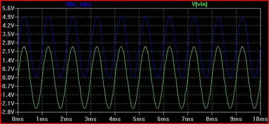

Here is a simulation:
Level Shift Sim
Note the input impedance is defined by R3, so you may need to increase this (and R2 by the same) or buffer if the source is high impedance. Also note that the output is inverting.

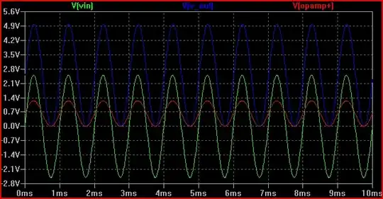

And the simulation (the "to_adc" is the output voltage):
Level Shift Non-Inverting
The above non-inverting circuit is a bit like your summing amplifier.
The summing amp you show has a problem though, the inverting gain resistors shown will not correct for the divider. It needs (R1 + R2) for the feedback resistor.
So gain equals ((R1 + R2) / R2) + 1.
Here is an example of how it should look (the a and b suffixes are just to keep SPICE happy):
Level shift summing
In the simulation you can see the opamp +IN swings from 0V to 1.25V, so it needs a gain of 4 to output 0V to 5V. Since R1c and R1d are in parallel, we get 50k. So (150k / 50k) + 1 = 4.

  • I'm curious, how did you size C2? – jippie Aug 03 '12 at 06:27
    I didn't actually size it for this particular question, it's a remnant from a previous schematic I adjusted for this answer (I left it in as it's always a good idea to have a small cap across Rf to prevent oscillation, but didn't want to go into more detail in that area) However, as shown the bandwidth would be 1 / (2pi * C2 * (R1+R2)) -> 1 / (6.28 * 100e-12 * 150e3) = ~10.6kHz. For an ECG, the bandwidth could be reduced plenty more. – Oli Glaser Aug 03 '12 at 06:35
  • Thanks for your detailed answer. I just tried your non-inverting circuit, but I seem to have run into some problem. Even though the input signal swings from -2.5 to 2.5 V, the output of the amplifier swings between 1V and 3.3V only, I don't know what is going on.. I am using LM358AN – govind m Aug 03 '12 at 07:17
    The LM358 is not a rail to rail opamp, specifically the output won't swing all the way to +5V though it should reach ground. The input is not rail to rail either. Also, if your source impedance is high (e.g. > 5k) you will need to buffer the signal before sending to the level shifter. – Oli Glaser Aug 03 '12 at 07:35

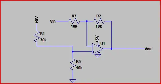

  • Looking at your inverting example, it inverts the signal and amplifies it by R2/R3=1, and adds on the voltage-divided offset fed in through the non-inverting input. Wouldn't this offset voltage need to be +2.5 or 5V*30k/(30k+30k) with R1=R5=30k to make the output V_out=-V_in+2.5V? (I'm trying to shift a +12/+11.3 signal down into the 0-5V range.) – Dave X Nov 18 '21 at 20:02
  • I really like your inverting level shifter circuit here. There isn't much on the web about level shifting while inverting. I asked about my inverting-downshifting use case at https://electronics.stackexchange.com/questions/595701/level-shifting-a-11-3v-12v-signal-down-to-0-5v-with-an-inverting-op-amp-level-sh and got a good answer. – Dave X Nov 21 '21 at 17:54
