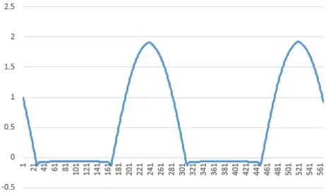

  2. Now, I've connected a function generator, sending out +/-2V amplitude of analog sine wave signal, to the waveshare ADC board.
  3. By modifying the sample code provided, I've printed out the converted data and ploted them, which is the figure shown below (y-axis = voltage, x-axis = number of data)
  • figure 1: sine wave plot
Here are the questions:
1. Is this normal phenomenon for this ADC board?

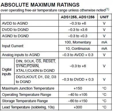

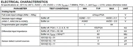

2. If so, am I correct to assume that this ADC can only receive analog inputs above zero? (I've looked through the ADS1256 datasheet and studied a bit, but had hard time understanding the input range found in the document, shown below.)
3. If above assumption is true, then can the analog input range be changed?
  1. I've been told (As @Milliways had suggested) that there are established techniques to offset input DC. To elaborate, I need to change the input range of the ADC from 0 to 5V to -2.5V to +2.5V. Can this be done by changing ADC registers or do I need a separate circuit like op amp?
  • figure 2: datasheet screenshots, page 2 and page 3
The data sheet tells you the maximum working input voltage range for the ADC: -
You are pretty much limited to input voltages between AGND and AVDD - 2 volts with the buffer active and slightly better if the buffer is inactive.
If you have signals that drop below 0 volts then you need to offset them in hardware. An op-amp could work but it depends on what your signals are.
