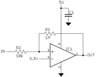

The simple and obvious answer that meets your specs is:
This thresholds the input around the midpoint of what you say the high and low levels are. In practise a little hysteresis is probably wise:
This will create about a 50 mV hystersis band. For example, when the input goes high so that the output goes high, the input has to go 50 mV lower before the output will go low. The hystesis band will be a little assymetric due to your threshold of 3.3 V not being in the middle of the output. This can be compensated for several ways, including adjusting the reference voltage fed into the negative input. Let me know if you want to get into those details.

    I think the OP wanted the output to be 0V and 0.5V, but this looks like it would output 0V and 5V. – Phil Frost Dec 05 '14 at 15:37
  • 0 to 5V is actually better for me, since I was planning to amplify it. – user16307 Dec 05 '14 at 15:50
  • I will count the pulses. Do you think I need to think about 50 mV hysteresis band issue? What farad is C1? Can I use LM324 which is the only op-amp I have currently? – user16307 Dec 05 '14 at 15:53
  • @Phil: Oops, I missed the decimal point before. Turns out the OP apparently wants more anyway, so I won't update the answer, although a voltage divider on the output of the above circuits could address the issue if 0 - 500 mV was really wanted. – Olin Lathrop Dec 05 '14 at 18:12
  • @user: C1 is just a bypass cap, around 1 uF ceramic. LM324 should work well enough assuming your signal is within its bandwidth capabilities. – Olin Lathrop Dec 05 '14 at 18:14

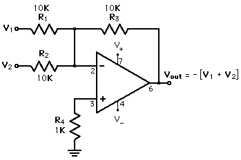

Use an op-amp to create a mixer circuit and subtract the 3.07 volts from the signal: -
V1 can be your input and apply -3.07 volts DC to V2. If you want to restore the polarity of your signal (because Vout = -(V1+V2)) use an op-amp inverter afterwards.

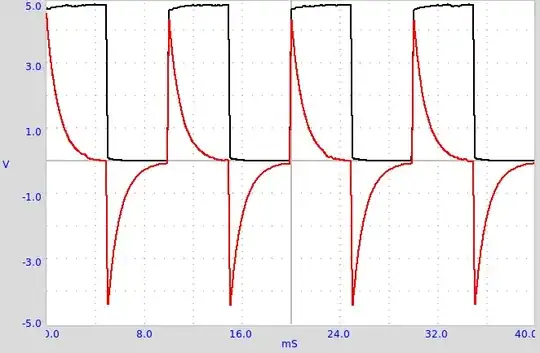

Alternatively, you can use a high pass filter to largely differentiate the composite signal leaving no dc offset and spikes. The spikes will rise positive for edge transitions that were positive and there will be negative spikes for negative edge transitions of the composite signal. Then use a comparator with hysterisis to convert this back to a logic-level signal.
(source: expeyes.in)
If red signal is fed to a comparator with some hysterisis it will toggle the comparator each time a pulse/spike rises above the comparator threshold thus resoring the sq wave. Ignore the scales on the picture above - they are not important but the concept is.
