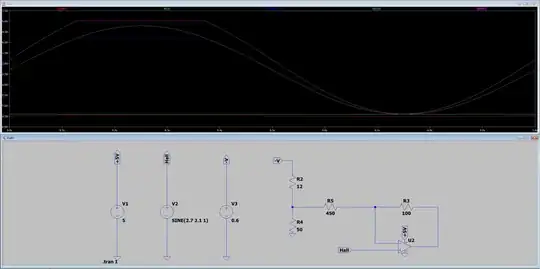

I am trying to create a circuit that takes a 0.6V-4.8V input, and scales it to a 0V-5V output. I was thinking of using a rail to rail Op Amp, like this one (TLV9041 DCK SC70). I also used a guide put out by TI about designing and system with gain and offset, but when using the calculated resistor values, the output wasn't what I expected. LTSpice has an Opamp called UniversalOpamp2 which I was using to sim.

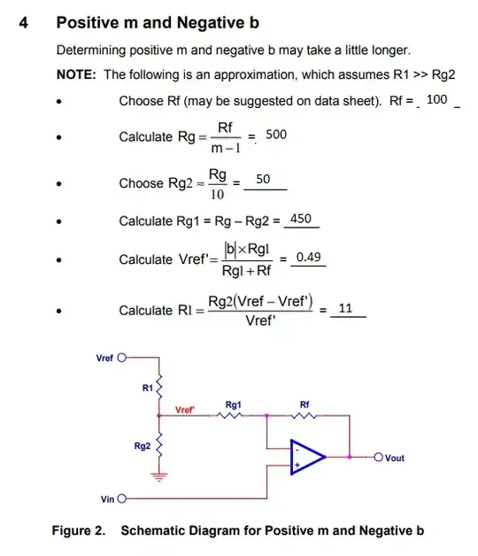

In the guide I used section 4 which details a system with a positive gain, (m), and negative offset, (b). I set the gain to be equal to 1.2, and the offset to -0.6. Below, I set Rf equal to 100 Ohms, and solved for the other values based on that.
With those values, this is the LTSpice model.
For clarity, the cyan wave represents the DC input of the signal I am trying to shift down. The input will be between 0.6V-4.8V. The green line is the 0.6V I am trying to shift down by. The pink line is the current output, which is just an upwards shift of the V- input.
I believe that since the input V+ signal is always larger than the reference signal, the Opamp will always be active. I can see the the wave of the output, however, I am getting saturated on the upper end and I believe its because the shift is not occurring. I'm sure there will need to be some fine tuning on the gain.

**Original post had the Opamp flipped, updated post reflects the "correct" orientation.

    Hey, dude. You sure you just don't have your (+) and (-) inputs on the opamp swapped? – Ste Kulov Dec 08 '21 at 18:45
  • @SteKulov That fixed a glaring issue, though I am still having a bit of trouble with the shift and saturation. I'll update the original question, thanks for catching that – JTH828 Dec 08 '21 at 18:50

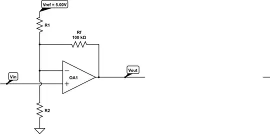

  1. Your +/- inputs were swapped.
  2. Your resistor values are way too low for that (and most) op-amps
  3. I think you want the Vref to be something other than 0.6V
  4. In general this exercise is not something you should do- the op-amp is called Rail-to-rail but won't swing exactly to the rails especially when it is sinking the current from the offset network. Better to go directly into the ADC (buffer it 1:1 with that op-amp if you like). You only lose ~16% of resolution and gain in a number of ways. The manufacturer of the sensor intends it to be used directly with a 0-5V ADC.
  5. If you still insist, note that the very ends of the input range won't be accurate (so don't use them for calibration) and also note that Rg1 is unnecessary, you can make Rg1/R1 higher and eliminate it. I'll do a sample calculation just for general interest but give it enough supply voltage it works well (which can cause other issues...)
Just for fun, here is how you can calculate the values. You should not do this. You want an output voltage change of 5V for an input voltage change of 4.2V. That means a gain of 1.1905. Let's arbitrarily pick a feedback resistor of 100K (relatively high to minimize loading on the CMOS op-amp).
That means that R1||R2 = 100K/(1.1905-1) = 525K.
Now, we want an output voltage of Vout = 1.1905Vin - 0.6*1.1905 so it is zero with a 600mV input. That means that (theoretically) the output voltage would be -0.7143V with 0V in. That eliminates R2 from the equation for KCL and we can calculate R1 = 5V/7.143uA = 700K. Then R2 = 1/(1/525k - 1/700k) = 2.1M ohm.

  • Should my Vref be a bit higher in general than what I am trying to set as lower limit? And I'll look to avoid this in practice. For the buffer, I would just be amplifying the signal in essence? I could be misunderstanding. I imagine the manufacturer would intend for the signal to be scaled in the FPGA in this case. – JTH828 Dec 08 '21 at 19:06
    You want your signal range to stay a bit away from the supply rails. And if Vref is your supply rail, then that applies too. Once it's in the digital domain you can scale and offset as you like. – Spehro Pefhany Dec 08 '21 at 19:09
  • The buffer (if used) would mostly be because you wanted to filter the input signal, for example, for an anti-aliasing filter. – Spehro Pefhany Dec 08 '21 at 19:45
