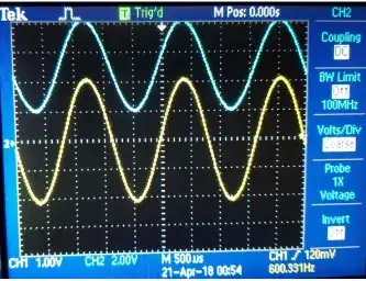

Design a circuit that gives the following output using only (1) op amp, 1 nF / 1 uF capacitors, 10k resistors, and diodes, (we can also use variable resistors but I don't think we need those).
This is the picture we were given -
Starting off, I see that this is a sine wave with a peak to peak of -2V to 2V The output wave is a sine wave with a peak to peak of 2V to 8V. The output is also shifted up (dc offset).
I've tried many things - the first attempt I tried using an inverting amp and was able to adjust the offset of the input but the wave ended up being inverted. Any ideas on how to tackle this problem?

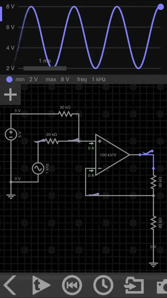

Your gain is 3/2. And your offset voltage is 5 V.
Try this: schematic
The 1 kHz AC input is +- 2 V, and obviously should be set to your actual frequency.
If you don’t have 5 VDC, you can use a resistive divider with a voltage follower.
Note - sorry for the crude schematic. I’m on my phone, and it’s the best I can do.
Per notes here’s an update, fashionable with lots of 10 kOhm resistors.
update

  • OP don't have 5 VDC supply, s/he/it got +10V and -10V - OP appears to be able to use infinitely many 10 kΩ resistors. This is what OP wants. - I deleted my answer because OP is too far behind, perhaps you have the energy to show the equations/math for it. I don't. – Harry Svensson Apr 26 '18 at 01:48
  • @HarrySvensson Agreed. That works as well. I mentioned in the answer that he would need to create the 5 VDC from the 10 V supply - and a voltage follower for less math :). Also, I thought I’d leave him with a least a little something to work out. It is homework. – Blair Fonville Apr 26 '18 at 01:55
  • @HarrySvensson “perhaps you have the energy... I don’t”... still, somehow I knew you wouldn’t be able to resist coming up with the perfect circuit! – Blair Fonville Apr 26 '18 at 01:57
  • @Bl hmm, weird, I can't use the @ function. Oh well. Right, I forgot to mention that he was only allowed to use one op-amp. - Playing around with experience in CircuitJS goes faster than setting up the equations, which I can make if I have time. - Oh well. You da man. – Harry Svensson Apr 26 '18 at 02:32
    Hmm, one op-amp. Fine! I’ll add a voltage divider - hope he has lots of 10 kOhms. – Blair Fonville Apr 26 '18 at 02:40
