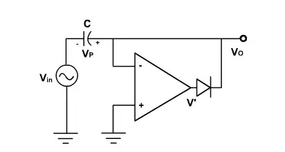

Give your input wave which you have to shift as Vin.
Ankit Sahay
  • 25
