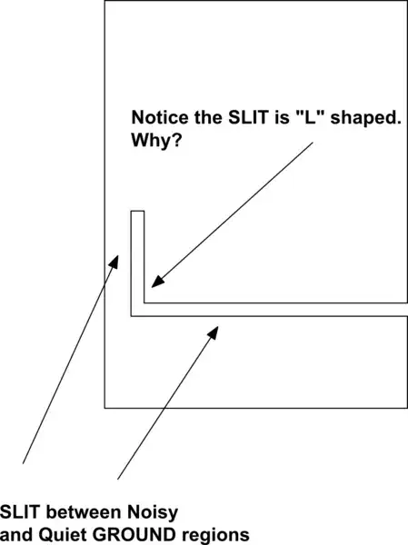

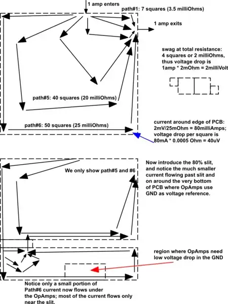

Simply introducing SLITS into the GND plane may suffice to largely keep digital/power/relay/motor trash out of the delicate analog areas. [ EDIT June 9 Showed a narrow region will achieve 12dB/square attenuation. EDIT June 2019 Remember to slit the Power Plane as well (suggested by barleyman)]
schematic
What can we predict about slit placement versus intrusive-current In point and Out point?
schematic
simulate this circuit
What to expect, as the slit intrudes into currents?
schematic

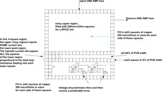

We had approximately 40 microvolts/square along bottom edge of the PCB, assuming 0.0005 Ohms/square. We can estimate the I*R voltage drop, caused by ONE AMPERE at top right of PCB, along the very bottom edge of PCB inside the analog region as simply
Slit_Atten = length of slit / entire loop length inside the sensitive region
Voltage drop at very bottom (per square) is
Voltage across slit * Slit_Atten
Math: slit is 4 squares, thus 4 * 40uV = 160uV.
Slit_Atten is 4 squares / 20 squares (entire loop periphery) = 20%.
The per_square I*R drop is 160uV * 20% = 32 uV.
This shows the value of using only NARROW regions between digital/noise and analog.

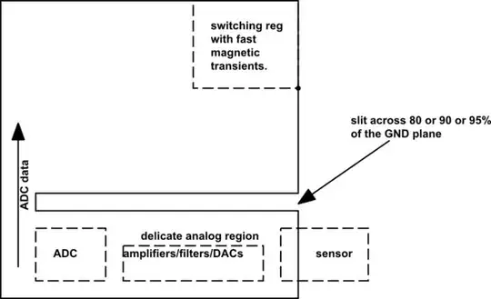

Here is another way to slit.
schematic
Voltage per square where OpAmps need quiet GND = 32 uVolts, per square. Not very quiet. What to do?
1) cut the slit further into the planes; now at 80%, go to 95% and likely get an exponential improvement in quietness; run the SPICE sim and see how

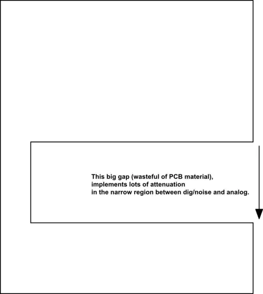

2) make the slit ----- not narrow ---- but deep, like this

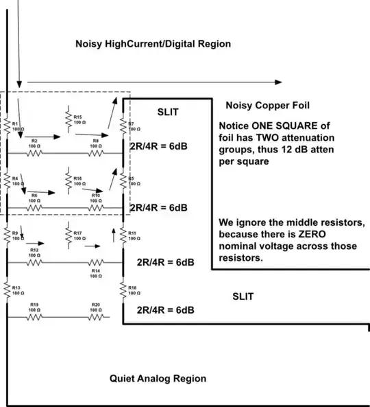

What can we predict about the attenation of "L" slits? Turns out we can predict 12 dB attenuation per square of the narrowed-region. We zoom in, and see this
