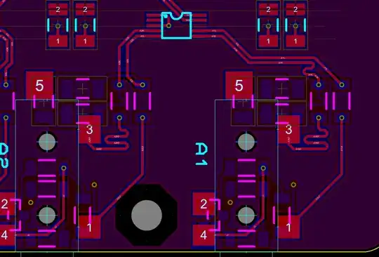

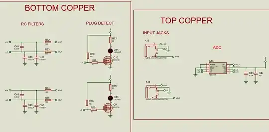

I am designing a PCB which reads analog signals via some ADC, my circuit looks like this:
There are four of those in a single board. My top copper is filled with a power plane (3V3) and bottom copper is filled with a ground plane. The components under the pad 1, 2, 4 of A1 or A2 are the plug detect components, and components near pads 3 and 5 are the filters.

  • @PeterSmith shaping seems to be the common answer for articles, separating the ground planes is also be called shaping since they will be connected back to each other somewhere. I apologies it seems to be a lot to take in for me yet. You mention of "make the return currents flow where you want them to go" which of the devices would i particullary look this out for ? the Analog components or the digital components? I assume the digital components is the one responsible for making the noise and messing up the analog signal correcT? – Jake quin Apr 10 '20 at 13:27

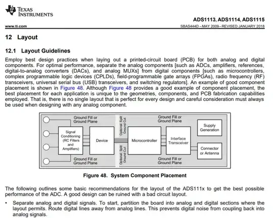

It's all there in the data sheet for the ADS1115 (the ADC you are using): -

  • Unfortunaly i cannot accomodate battery( chemical reaction battery, im not sure if you ment this) to my design. Can you check my proposed new PCB layout that utilizes slits in planes from which i was influence by your answer to this question. – Jake quin Apr 12 '20 at 13:29
Generally, these splits of GND planes are made as a function of frequency. As your sampling speed on the ADC goes up, you can see harmonics between the power supply feed-through from the digital and the analog sampling clocks. You can overdo this however, I have seen people arbitrarily spit planes and then had to rectify the ground loops. 70Hz is relatively low speed. If each device on the digital side has it's own capacitor to debounce it, you are unlikely to see feed through on the supplies lines.
For 1GHz sampling ADCs, we generally have matched line lengths and no planes due to how much charge "sloshes" around on the planes.
