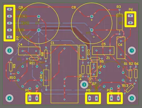

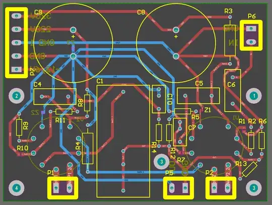

I'm currently designing my first audio PCB. I've read a ton of discussions and guides about audio grounding, so I've decided to use single point grounding (with the point being last filter capacitor minus).
However, one question arised in my head and I haven't found an answer. Is it beneficial to the circuit to make a fill on the PCB, connected with ground at the single point?
It seems logical to me, that a fill on the PCB would reduce noise and crosstalk between signal traces, while connecting this shielding plane to ground in single point would eliminate all current return problems which normal ground fill would cause. Ideally, no current would flow through this plane, as whole circuit itself is connected following the idea of single point.
On the other hand, it could make the ground noisier, as the ground plane is sort of an antenna.
A following question would be - if my conclusion is correct, should I connect the fill to quieter preamp ground (which is more sensitive) or noisier power amp ground (which wouldn't care too much if its ground would collect some noise)?
Edit: To clarify: this is not a debate between single point and plane grounding. Grounding of the circuit WILL be done via routing components to the single point only by 1mm traces!
The point is: is it beneficial to put a separate fill on the PCB and connect it to the circuit ground in the single point (not connecting any component to the fill)? Will it increase or decrease overall noise if there is a screen added? Again - the fill will be connected to the ground at ONE POINT, no component connected to it. This is the PCB without any pours: no plane This is what my idea of screening fill would look like, notice that both bottom and top fills are connected to anything only under C8 cap, components are still connected to their single points: plane
With a large ground plane the impedance is very much lower than individual tracks and hence any signal current passing through the plane produces a very much smaller associated volt drop. That volt drop might be a lot bigger if your audio circuit has significant gain and ability to drive low value loads.
That volt drop may be quite distorted if you are using push-pull amplifiers. That volt drop (even though you are using a plane) may produce small distorting signals at the sensitive inputs to your amplifier. That can produce feedback and distortion.
On the other hand, if you restrict the higher current flows to their own tracks and star-point all ground returns to one point then it's usually a better choice for audio.
You seem to be missing the point about star pointing - the point is that you use individual traces/wires to this star point and not a plane that en bloc connects to what is an arbitrary 0 volt reference. The point is to avoid high signal currents mixing with low signal currents and thus creating anomalies.

  • I think we're not understanding each other. I've got the circuit routed in a single point manner, and the hypothetical copper fill I'm asking about would be connected at the single reference point only. No component would be connected directly to the fill, each ground connection of a component will still be routed via 1mm trace to the reference point. The fill would act like a screen only. – Tomasz Kowalczyk Jul 06 '17 at 09:21
  • Then I don't understand what you mean by a fill - if you mean allowing an unconnected net to pour into all the gaps left between the 0 volt points then you make a single bond to the star point then that could help a tad but it could also hinder a tad. Hard to be precise. – Andy aka Jul 06 '17 at 09:40
  • @TomaszKowalczyk We don't know your circuit. If it has very high-impedance nodes, your fill shield may have some merit. If not, it is a waste of copper that could otherwise carry current. Knowing where heavy currents flow, and knowing which nodes are sensitive to small voltage drops along traces (usually near inputs) helps in allocating copper where it is needed. Andy is saying something similar in his last paragraphs. – glen_geek Jul 06 '17 at 11:46
Draw out your entire system, and draw the sensitive paths (the audio input, where 1microVolt trash will set the SignalNoiseRatio). Draw the ClassB current surges, for Up and for Down currents to the speaker. Draw the 120Hz rectifier diode surges, with the 10 amps/10microsecond risetimes.
Convert your drawing into 1centimeter squares (or 1/4" squares) and sit back and examine the current flows. Now accept each square is 1/2,000 Ohm or 500 microOhms; this value depends on foil thickness and temperature (copper is very temperature sensitive at 0.4% per degree Cent).
Begin to visualize the voltage drops from ClassB surges and from rectifier surges.
How to isolate those voltage drops from the sensitive audio inputs?
Then go read this answer Should I really divide the ground plane into analog and digital parts?
and notice (far down in the answer I provided) how long regions of copper provide 12dB of attenuation per square of copper.
