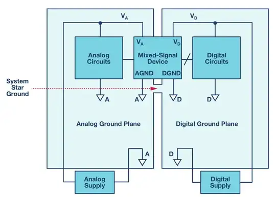

I have an STM32F051 MCU, A XBEE module and an analog sensor I want to read its value using my MCU. I've read (and also practiced in action) that to have a precise ADC readings(which is important for my application), you have to separate analog and digital grounds, like this figure: enter image description here
I have two questions:
  1. Where should I connect the regulator ground? AGND or DGND? Why?
  2. Where should I choose as a star point for connecting two grounds? Regulator or near the MCU?

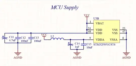

Here is what my MCU power pin connections look like now(I've assumed the regulator as the star point, So I've connected the MCU to the AGND): enter image description here

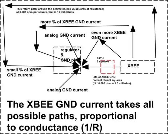

Consider this diagram showing return currents WITHOUT SLITS, for high current (XBEE) loads
schematic
As all the GND current crowds into the regulator GND pin, the change in current --- 50mA --- scaled by PCB foil resistance near the GND pin, will cause a change in voltage. Sketch out that current crowding. Assume 3 milliOhms resistance around the pin. 50mA change causes 150 microVolts upset. Is 150uV smaller than your ADC quanta? 10dB smaller? 20dB smaller?
How to keep the XBEE currents out of the analog region? would your original diagram, with one tiny connection point, achieve that isolation? YES. But currents needing to cross that tiny connection point will cause I*R voltage drop.

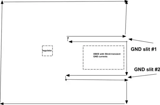

How about THIS use of slits, on either side of the XBEE
schematic
simulate this circuit

  • So based on the link you provided, It will be just enough for my setup to place the components wisely thus XBEE current won't flow near my analog circuitry. Is it correct? (As you know XBEE draws about 50mA when transmitting) – MHTB Aug 25 '17 at 14:30
  • Sketch out the current flows in the GND plane. Perhaps use slits to steer the XBEE currents back toward the regulator GND pin. – analogsystemsrf Aug 25 '17 at 14:35
