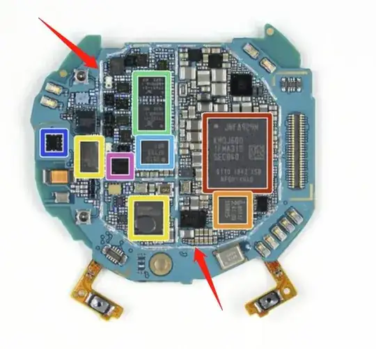

Whenever I go through datasheets of boost ICs, MCUs, RF power amplifiers, filters, they have recommended designs for best performance.
For example, where decoupling capacitors should be placed or how X track should be as far as possible from Y domain components.
But when I see teardowns of big tech company products, I see tightly packed passive components right next to each other holding hands.
How is that possible? What am I missing? What do those engineers do to put components so close to each other as shown in image below Galaxy watch teardown and still get the best performance out of them? enter image description here EDIT: What are these dashed lines marked by red arrow? seems like separation of analog and digital domain. But how are they achieved in inner layers?

  • Can you elaborate more on "By inserting series resistors, 1 ohm or 3.3 ohm or 10 ohms, in selectric places, the VDD foil becomes a VDD_TREE."? Do you mean converting this in star topology with each branch is different IC, Having its own RC filter for localized filtering of interference creeping in through power rails? – Curious KP Sep 13 '20 at 17:29
  • Can you also tell me about red arrow marked areas, How is that achieved in actual design? Is it just exposed copper? What about internal layers under that. – Curious KP Sep 19 '20 at 02:09
  • if you mean the solder-silver areas: yeah, just a copper plane (good chances: ground) exposed. – Marcus Müller Sep 19 '20 at 08:05
