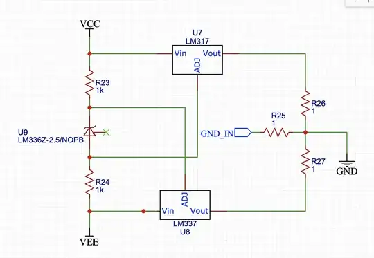

Regulated Ground Plane Example: Regulated Ground Plane

  • @Justin - For example if you use a lm336 in the center of a voltage divider (with two resistors of equal value) you would have 1.25v and -1.25v. You can use a lm317 from the positive rail referenced to the -1.25v to give you near zero and the lm337 referenced to the +1.25v from the negative rail to also give you near zero. Throw in some very low value resistors to account for slight offset and you would have a "regulated ground" such that if the voltage increased or decreased the regulators would keep the voltage at near 0. – Boeggs Jul 30 '20 at 14:56
  • So it may be possible to have several points on the circuit board be regulated to an average voltage closer to ground than you would otherwise get with a normal ground plane. I'm suspect it would be more complicated than the way you describe, but I'm sure there is a way. However, there's almost never a good reason to do this. What we are usually more concerned about is high frequency signals causing temporary disturbances in the ground plane. The regulator would have some delay responding to this temporary disturbance. ... – Justin Jul 30 '20 at 15:04
  • ...This would end up causing voltage spikes that would probably be larger (probably much larger) than the simple continuous ground plane method. The other thing to keep in mind is that if you need an very precise supply voltage at a certain circuit (supply voltage minus ground voltage), you could just put a local supply regulator near the circuit that regulates relative to the local ground and achieve the same thing with more normal methods. – Justin Jul 30 '20 at 15:06
  • @Justin I see, so for example in a audio amplifier having a regulator for both positive and negative voltages in close proximity to the power stage would be better due to the fact that the positive and negative regulator will respond to any voltage changes on the nearest spot on the ground plane anyway, keeping the voltage regulated. Also I added a schematic above of a regulated ground that I tested working. I was originally using it to split a single ended supply and produce a virtual ground. – Boeggs Jul 30 '20 at 15:11
  • Cool that your circuit was working, I don't really understand it myself. Are the two regulator output voltages supposed to be at 0V, or some perfectly balanced opposing voltage? Just wondering how you met the 3mA minimum output current spec on the regulators. – Justin Jul 30 '20 at 15:16
  • @Justin I am kind of an electronics noob but my thought was the two regulators are supposed to be at nearly 0 volts. Each regulator has a small offset from each other / 0volts and thats why I added the 1 ohm resistors to account for that. On the topic of the minimum output current spec I don't really have an answer (in all honesty I didn't even know that was a requirement until you mentioned it). Maybe the offset between the two regulators allow for a constant current draw of > 3mA? – Boeggs Jul 30 '20 at 15:29

  • Hey @analogsystemsrf, thank you for validating my understanding that there is in fact voltage transients on the ground plane. Also after reading your post that you linked I will definitely take that into account when designing my next pcb. A single question I have remains. Lets say in a amplifier design where you have a opamp pre-amp stage, and 2 separate bjt buffer stages. Then lets say for the pre-amp and each individual buffer stage you have a lm317/337 creating +-17 volts and then use the circuit I exampled above to create the ground plane for each sub-circuit. Would giving each.... – Boeggs Jul 30 '20 at 16:13
  • individual sub-circuit it's own ground plane referenced from the +- rails be worthwhile? (No connection to the primary ground from the transformer other than the +-17volt regulators, the ground planes would not have any connection at all to the incoming ground from the transformer and instead all be separated) – Boeggs Jul 30 '20 at 16:13
