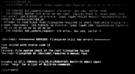

I'm learning a little about fsck on the fly, but what I am finding so far doesn't seem to do very much when I apply it. What would be the next step from this prompt to repair the errors I am having when booting?
fsck reports that filesystem still has errors - manual fsck required

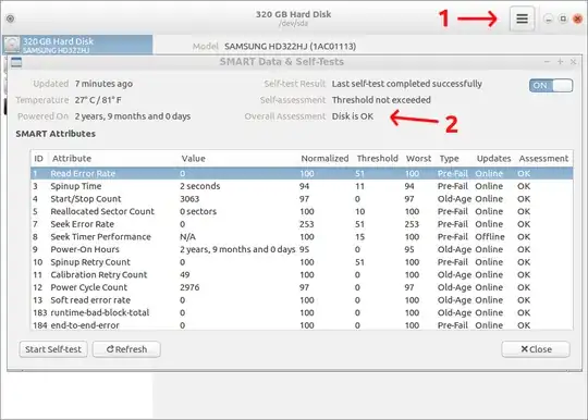

S.M.A.R.T. information of HDD and SSD
Check the S.M.A.R.T. information. It is easy using Disks alias gnome-disks according to this link,
Reformating hard drive after malware damaged boot sector - scroll down to 'Maybe the disk hardware is damaged'
Select S.M.A.R.T. via the button at (1) and check the overall assessment at (2).

I'm afraid that your HDD has badblocks or it is defunct. Do you see this message: blk_update_request: I/O error, dev sda, sector 2048? It means that it is impossible to read this sector from physical device.
You need to boot from a LiveCD and check you drive with:
$ sudo smartctl -HA /dev/sda
and check the line SMART overall-health self-assessment test result: PASSED and the line Reallocated_Sector_Ct should contain 0 in RAW_VALUE field.
If SMART self test is PASSED you can try to 'remap' badblocks with badblocks tool:
$ sudo badblocks -svo ~/msg.log /dev/sda
and run fsck after:
$ sudo fsck -a /dev/sda1
If SMART self test is FAILED you need to replace your HDD.
PS: All these steps you should do from LiveCD session. And you have to replace /dev/sda to your drive.
