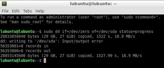

I was "zeroing" my drive with the dd tool when I get this input/output error:
Input/output error
Is my drive good for trash or is there a way to fix it please?
Thanks a lot for your answer :)

After all this, I try another dd with default bs value, just to be sure:
sudo dd if=/dev/zero of=/dev/zero status=progress
Currently, dd has written 78 GB without any error and it goes on...
Do you have any idea of what happened?
Thank you :)
Zanna
  • 72,312
Frankie
  • 31
I have encountered this problem with a bad block as well. The drive likely has a sector size of 512 bytes, but a block size of 4096 bytes, which is the minimum size available to disk I/O (see e.g. the output of blockdev --report). dd is fine with writing to healthy areas of the drive using the default size (512), but requires writing a whole block if there is a problem (bs=4096).
This answer provides the reasoning: to write only one sector of a block, the whole block must be read first, then the sector data will be changed and the block written back. In our case, the read fails, so that whole operation fails with bs=512. However, with bs=4096, no reading is necessary, since the whole block will be replaced; therefore, the operation succeeds.
The idea of using dd to write zeros to the drive is to force the drive firmware to confirm the health of every sector and remap any bad sectors to the reserved area. Once the bad block was successfully written to (then either confirmed healthy by the drive or remapped), the badblocks tool (which is a higher-level tool) was happy, because the bad block was hidden from it, and the smartctl tests passed as well.
