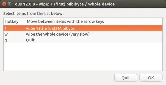

It is enough to wipe the first few bytes, but wiping the first mibibyte will be enough for this purpose as well as removing other data that might disturb or confuse the function of partitioning tools like gparted. There is a menu entry for this task in mkusb. You may want to wipe the whole drive (if you suspect that there is other malware somewhere in the drive), and there is also a menu entry for that task.
