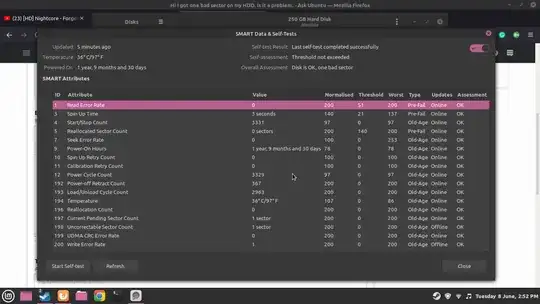

SMART data for HDD screenshot
I have had this error for a while now. Is it safe to use?

Here is the proper way to bad block your hard disk...
Note: do NOT abort a bad block scan!
Note: do NOT bad block a SSD
Note: backup your important files FIRST!
Note: this will take many hours
Note: you may have a pending HDD failure
Boot to a Ubuntu Live DVD/USB in “Try Ubuntu” mode.
In terminal...
sudo fdisk -l # identify all "Linux Filesystem" partitions
sudo e2fsck -fcky /dev/sdXX # read-only test
or
sudo e2fsck -fccky /dev/sdXX # non-destructive read/write test (recommended)
The -k is important, because it saves the previous bad block table, and adds any new bad blocks to that table. Without -k, you loose all of the prior bad block information.
The -fccky parameter...
   -f    Force checking even if the file system seems clean.
-c This option causes e2fsck to use badblocks(8) program to do a read-only scan of the device in order to find any bad blocks. If any bad blocks are found, they are added to the bad block inode to prevent them from being allocated to a file or direc‐ tory. If this option is specified twice, then the bad block scan will be done using a non-destructive read-write test.
-k When combined with the -c option, any existing bad blocks in the bad blocks list are preserved, and any new bad blocks found by running badblocks(8) will be added to the existing bad blocks list.
-y Assume an answer of `yes' to all questions; allows e2fsck to be used non-interactively. This option may not be specified at the same time as the -n or -p options.

If there is one single bad sector, you can mark it in the operating system, and live with it.
It is a good idea to check regularly, if there is an increase of bad sectors, or in general to check the S.M.A.R.T. status of the drive.
See the following links,
FSCK reports that filesystem still has errors
Repair the partition table and file system of a pendrive - If an Ubuntu file system, scroll down to 'Repair linux file systems with linux tools'
