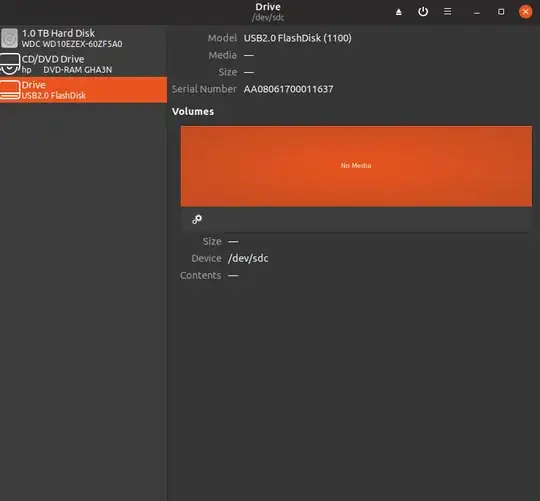

I have a problem with already 2nd USB drives, most probably due to the reason of choosing slow formatting option. Because it takes a LOT of time, I probably forget about it and accidentally break the formatting process. Now I have 2 completely useless USB drives.
Ubuntu can't read them, actually, Disks application recognize them, but there are very few options offered: "Edit Mount Options", "Eject" and "Power Off". Gparted doesn't recognize it, as well as testdrive and fsck ("No medium found while trying to open /dev/sdc").
I suppose that drivers for recognizing USB drive are corrupted or maybe there is some bad sector in an important part of the memory. I hope there is a way to make this 2 USB drives alive again.
I know how this will sound, but...I also break slow HDD partition formatting after 12 hours (accidentally), and I didn't have any problem. So there is my hope that it is possible to fix USB drives.

  • If a hard disk drive,HDD, or solid state drive, SSD: Check the S.M.A.R.T. information of the drive (to tell if there is something fundamentally wrong with the hardware).
  • For all drives, mass storage devices including HDD, SSD, pendrive, memory card:
    1. Try with mkusb to wipe the first mibibyte, and if successful, try again with gparted to create the partitions you want.
    2. If still problems, analyze them and try again to solve them according to this link.
