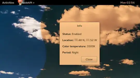

Instead of writing cron jobs to manually change your display's brightness, you might want to have a look at redshift, a program that can do exactly this. It can be set up to track daylight at your location, and change both your display's brightness and color temperature to better match natural light.
Image illustrating the effect of redshift
Its main selling point is changing the color temperature (i.e., shifting the color more towards the red, which is where the name comes from), but it can also adjust brightness. You could configure it to do just brightness, if that's what you want.
The main advantage over the manual solution is that redshift changes color/brightness gradually, matched to the current daily cycle of your location, rather than in steps as with your cron approach. You can also switch the effect on/off rather easily; sending the process SIGUSR1 will toggle the effect. I made a keybinding that does killall -USR1 redshift to make this easily accessible.
There is another program of similar functionality called f.lux, which also supports Windows and MacOS and seems quite popular. I have no experience with it though; in particular I'm not entirely sure if it can change brightness in addition to color temperature.
