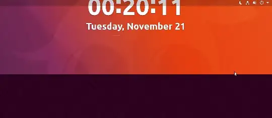

*/1 * * * * /full/path/to/gui-launcher "/full/path/to/the-target-application"
Here is how it works on Ubuntu 17.10 on Wayland:
