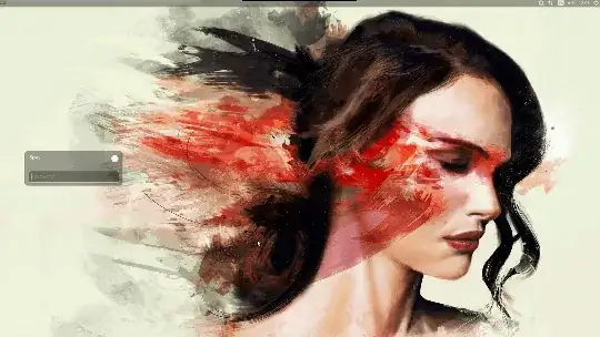

4. Here is presented how the script works:
