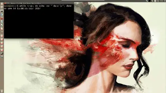

Demo - I just created a simple C program (this is my first attempt) to check how all this works:
