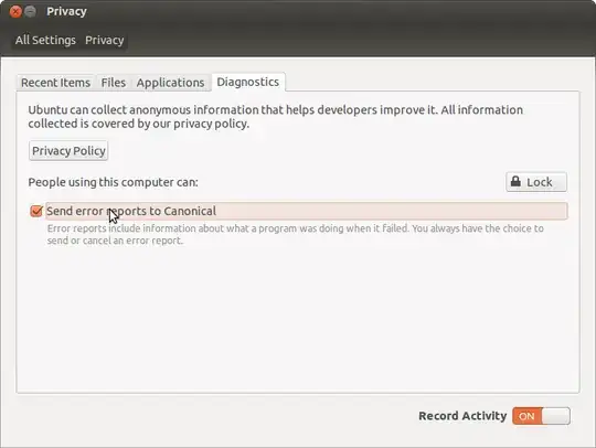

On Unity: 17.04 and below:
  1. Click on Ubuntu icon, search for "System settings"
  2. Select Privacy > Diagnostics tab
  3. Unlock
  4. Tick "Send error reports to Canonical"
    Ubuntu 12.04 > Privacy > Diagnostics tab > Send error reports to Canonical

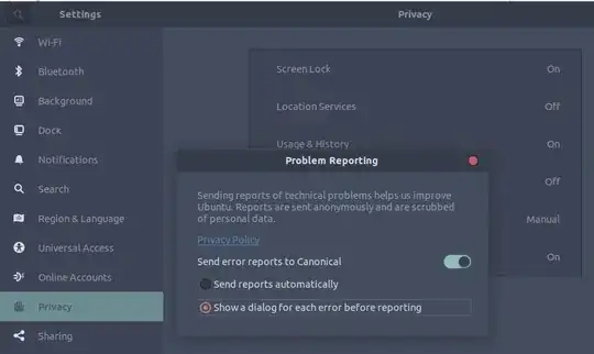

    On GNOME: 17.10+
    GNOME > Problem reporting screenshot
