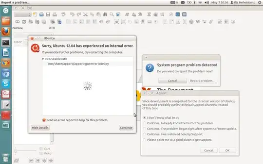

This started to happen immediately after I had rebooted the first time after doing a system upgrade. It first starts with a dialogue that says "System program problem detected". Then when I try to hit 'report problem' not much happens. I am led through a dialogue that always ends up the problem cannot be solved.
I am aware this is not a lot of information, however I'm not sure which information I need to publish and how should I obtain it to debug this problem.
Here's a screenshot! enter image description here

Open a terminal (Ctrl+Alt+T) and type:
sudo rm /var/crash/*
Then hit Enter.
This will remove any old crashes, that might still be reported (in error). After a reboot/re-starting, any further pop-ups still need to be investigated.

Ubuntu has an error reporting system called apport which tries to catch all program crashes in the background and report them to help the developers.
It seems that after a dist-upgrade there are some stuck reports that continue to display for unclear reasons, but disabling apport is not a desirable solution.
Remove old crash-reports
Open a terminal and remove all old crash-reports that might exist in the crash-report directory:
After a reboot the popups are gone.
If you don't want to reboot, you can close all open popups with:
killall system-crash-notification
