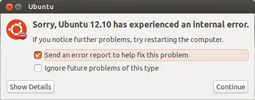

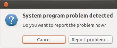

I am sometimes getting error messages like the ones below.
System program problem
internal error
As I understand they are from some kind of debugging mode in the beta which I sometimes install. I have no problem with them in the beta. If I install it I do because I want to report bugs. But if I switch to productivity I don't want them. Until 12.10 they stopped when the final was released and I upgraded, but not this time.
I'm not experiencing anything not working so the messages just annoy me by now. Can anyone tell me how to disable them?
Inspired by the answer by @ovc I looked up how to disable apport and found this question.
I had to edit /etc/default/apport and change
enabled=1
to
enabled=0
This way it is not started at boot. For not having to reboot simply stop the service with
sudo service apport stop
Let's see if the messages disappear now :-)

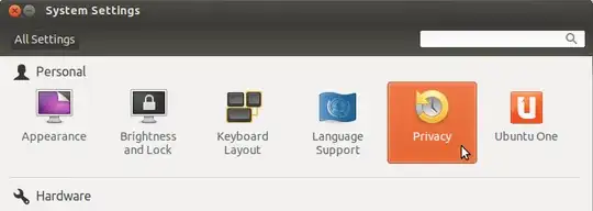

As pointed out by Robie Basak I was able to find my answer in context of another question. Here is the essential part from that answer:

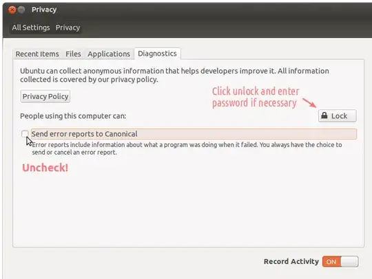

  • Go to Settings...Privacy...
  • And in the Diagnostics Tab, uncheck the Send Error Reports to Canonical option:
