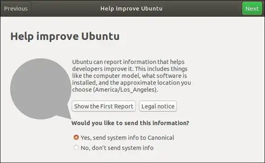

During installation of Ubuntu 18.04, after the runtime environment is enabled, and during the first login, a question pops up asking whether you want to Help Improve Ubuntu.
(Screenshot is from the 18.04 first-login "Welcome" process)
If you say yes, then a brief report is sent to Canonical describing basic characteristics of your system such as Processor type (AMD or i386), screen resolution and the default desktop environment. Nothing very intrusive.
This helps Canonical get an accurate count of installations and such. And they ask it so obviously and politely that I decided that "It's not a bug - it's a feature" and is OK by me.
So I said yes but now I have changed my mind due to the reporting that suggests that Canonical will become the next Microsoft - but do not want to reinstall my system.
How can I turn this feature off?

To opt-out of future telemetry reporting, issue the following command:
ubuntu-report -f send no
This command will send Canonical a brief message stating that your system is opting out of all future reporting. No other system data is sent.
Note that it still helps Canonical keep an accurate count of live installations.
Rather than simply appearing once in their records (a flash in the pan, or test installation) you will have notified them that your system is still running and that lack of future reports should be considered normal.

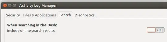

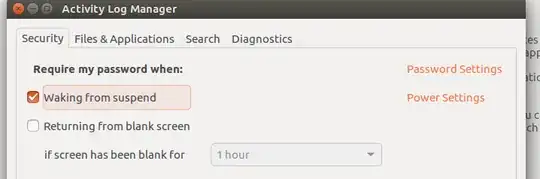

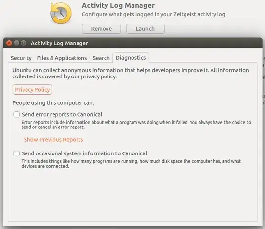

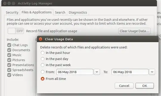

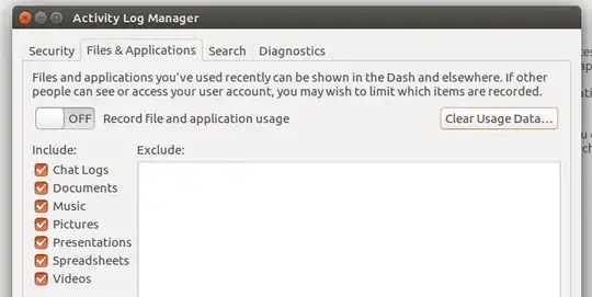

For Ubuntu 16.04 LTS, the settings are still available after install, at any time, in the Activity Log Manager.
Here are some screenshots of it in action:
The very first screen shot shows the sending of information to Canonical.
The rest affect the size of your log files.
