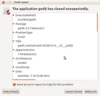

When you are filing a bug report, you can review what information is being uploaded for your own sake. Here's an image of an Apport crash dialog.
Apport bug
You should closely go through the information being provided under CoreDump and Stacktrace. If it contains information that you are not comfortable being uploaded, you can cancel the process.
