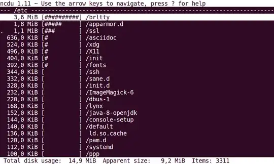

You can use ncdu for this. It works very well.
sudo apt install ncdu

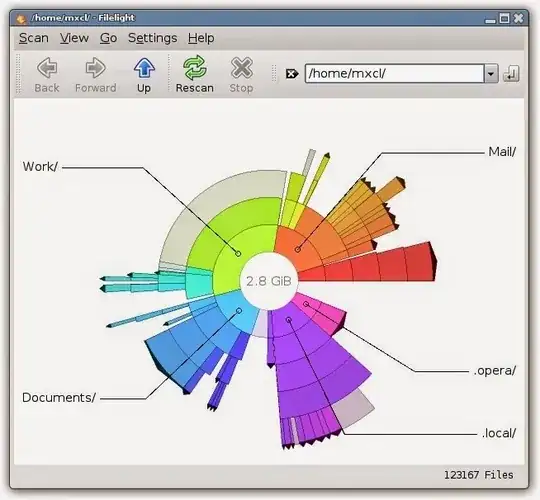

In case you are also interested in not using a command, here's an app: Filelight
It lets you quickly visualize what's using disk space in any folder.
