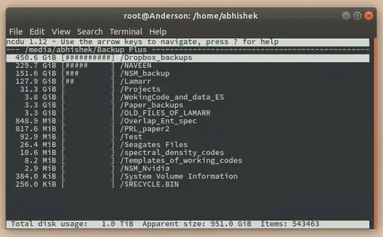

which does not add up to 1.8TB at all. Some people suggested using ncdu which also gives me the same output (shown below)
Results of ncdu :
output of ncdu

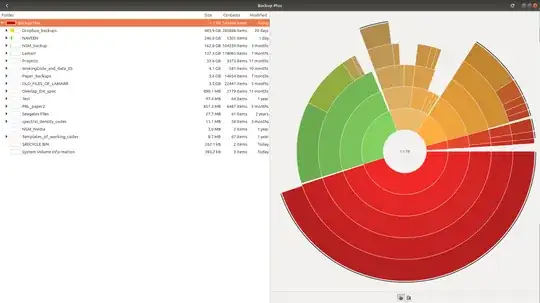

  2. Running the Disk Usage Analyzer on the drive gives the following enter image description here

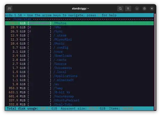

ncdu is a great utility for identifying large files and the folders containing them. It's in the archive, so sudo apt update ; sudo apt install ncdu will install it. Simply run it, either while in the directory you wish to examine, or give it a path as a parameter:
cd /media/abhishek/Backup\ Plus
ncdu
ncdu /media/abhishek/Backup\ Plus
It will take a short while to scan files and their sizes. Then it will present a view which you can navigate with the arrow keys. Importantly the largest folders will be at the top, so easy to spot.
Here's what it looks like:
ncdu
You may need to run it with sudo if there are files which aren't owned by your user in there, to be able to see everything. During the scanning phase of ncdu you'll see it report if there are files it cannot access, so the use of sudo may not be required.
