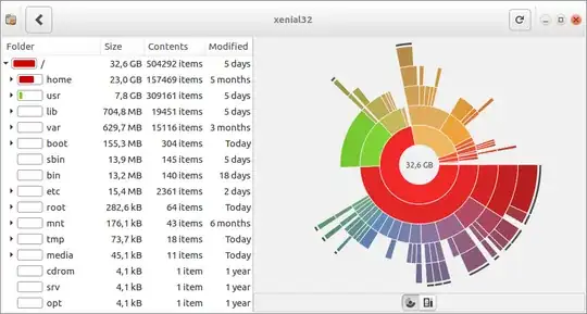

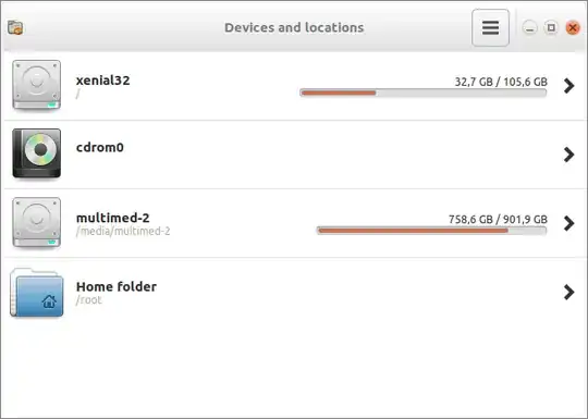

baobab
You can use baobab, which is a graphical tool, that displays the content with a list and a pie chart. You may need superuser privileges to see all directories and files. Do not run 'plain sudo', but use gksudo or sudo -H to avoid damaging your home directory.
sudo -H baobab
  • Select one of the partitions in the list
  • Wait while baobab is searching
  • Look at the graphics to find where most of the drive space is used.
