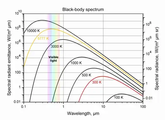

Those values in the thousands you referred to are temperatures in Kelvin. Each has a corresponding black-body (a star or anything that emits all wavelengths of light) emission spectrum.
Black-body emission spectra
So, if you pick a band of visible light (red, green or blue, for example) then find where the curves intersect those bands and this gives you their proportions. (Note: the scale on the graph is logarithmic; the differences are much greater than they appear)
I think 5777K is our Sun (it is kind of white). Remember, this is just the raw emitted light, all kinds of atmospheric effects can bend or scatter or absorb light along the way at different times of day depending on the angle of the Sun, thickness of atmosphere, what chemicals are in the atmosphere, etc. Read this paper for more info on these phenomena: Variation of outdoor illumination as a function of solar elevation and light pollution .
You definitely don't need all this to make a nice gamma changing script but it's good to have some idea of what you are actually trying emulate then you can pick nice values.
