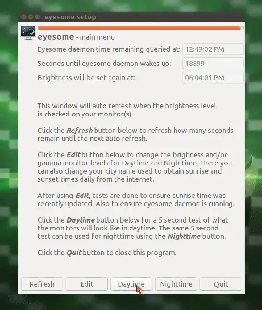

Eyesome Setup - Main Menu
When you run sudo eyesome-cfg.sh this main menu appears:

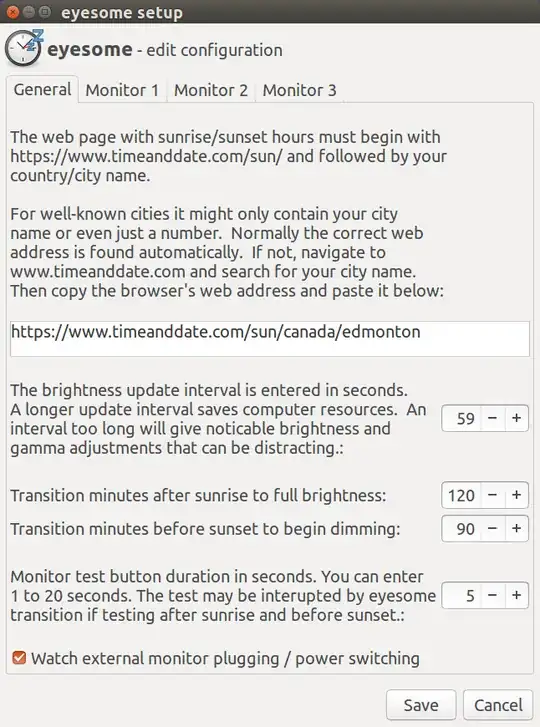

Edit Configuration - General tab
When you click the Edit button from the main menu the edit configuration general tab initially appears as shown below.
If the "brightness update interval" too short can cause too small hardware brightness adjustments that some laptops will ignore. If your screen isn't dimming before sunset, increase the interval to 60 seconds or more. You can watch the current brightness level change on the Monitor Tab. If for example you see the level changing by less than 21 each update interval, it's too short for a Dell Alienware 17R3 laptop. Yet a brightness change of 1 works fine on a Dell Inspiron 17" 7720 SE laptop.
Your "country/city name" should automatically appear. If necessary you can override it.
The check box for "Watch external monitor plugging / power switching" also applies for random times where some application invokes the color management dbus daemon that resets xrandr to 100% brightness and gamma. Unless there is a good reason not to, you should check this box.

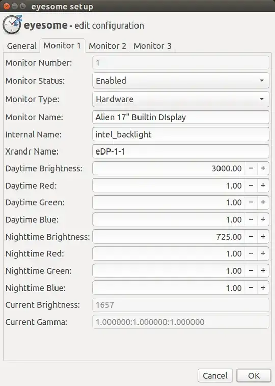

Edit Configuration - Monitor 1 tab
Clicking on Monitor 1 tab reveals this panel in my configuration (yours may be different):
Don't be daunted by these settings because most are automatically obtained by eyesome. You will need to set the daytime and night brightness/levels though.
If the gamma values for Red, Green and Blue are intimidating, you can fine tune them later with the Override button from the Main Menu. There you have access to a slider control for color temperature where 3500 is typical nighttime setting and 6500 is typical daytime setting. Typical daytime setting is 1.0 for Red, Green and Blue channels which is every systems default.

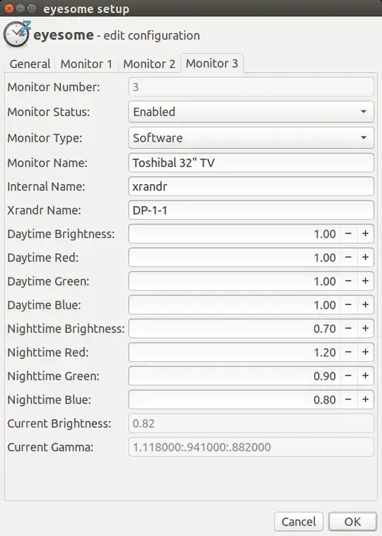

Edit Configuration - Monitor 3 Tab
Clicking on Monitor 3 Tab reveals this panel in my configuration (yours may be different):
Monitor 2 Tab is not shown because it is a new TV with adaptive brightness and Smart OS. It requires no overrides by Eyesome.
When eyesome is installed configuration is automatically created for the most part. If later on you attach a different monitor you may have to enter the xrandr monitor name.
Eyesome Setup - 5 second test
From the main menu you can test your daytime and nighttime brightness and gamma settings for 5 seconds by clicking the Daytime and Nighttime buttons respectively. You can change the duration of the test from 1 second up to 20 seconds from the Edit Configuration - General Tab.
Here's what the 5 second Nighttime test looks like:
In real life you see the screen dim dramatically if you run the test in the daytime. Screen recorders used to make above .gif animation cannot record the brightness or color temperature (gamma) change though.

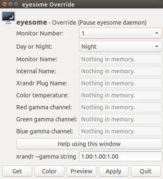

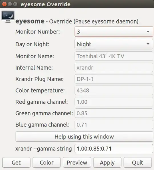

Eyesome Override
When you click the Override button from the Main Menu this window appears:

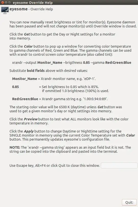

No doubt your first step would be to click the Help using this window button:
Assume we click the Get button and select Monitor 3, Nighttime setting:

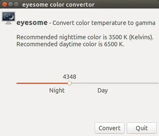

Now that we have default values in memory click the Color button:
Grab the slider and move it left to for warmer/redish color setting at night. Move the slider right for colder/bluish color setting at day. Click the Convert button to calculate Red, Green, Blue gamma channels or Quit button if you changed your mind.
