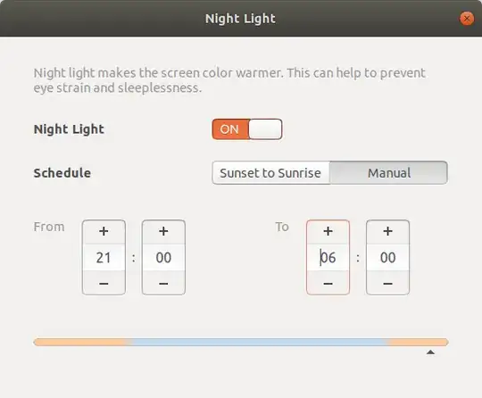

These days there's an additional solution that is very much like Redshift: it's available as a built-in feature in the GNOME desktop environment.
Just go to Settings → Displays and turn Night Light on. It lets you tweak the settings too:
GNOME Night Light feature
